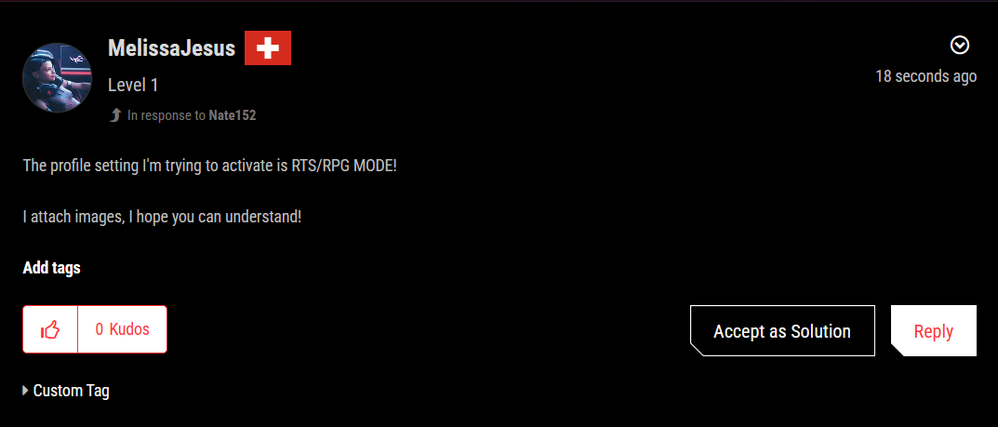

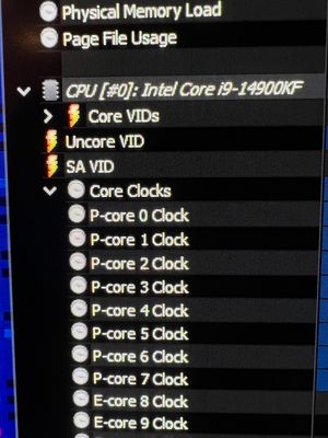

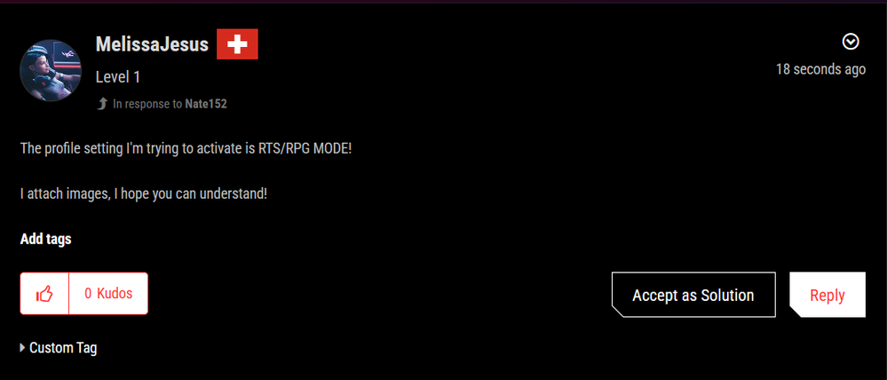

The profile setting I'm trying to activate is RTS/RPG MODE!
I attach images, I hope you can understand!

Thank you
I took some screenshots of your reply with RTS/RPG mode and Racing mode. I'm not noticing much of a difference, but for text, you might want to try a different mode. I personally use Racing mode.
RTS/RPG mode
Racing mode
But I look at the letters and they shake like an optical illusion, I think it's strange!

Here's Racing vs RPG
Racing
RPG Racing
If you're not used to OLED,  the PenTile arrangement may cause text to appear slightly fuzzy or less sharp compared to other display technologies, its one of its few shortfalls.
