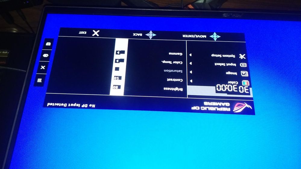

Fifth, the OSD menu of the monitor seems to be glitched as-well. I will share a video on how it looks.

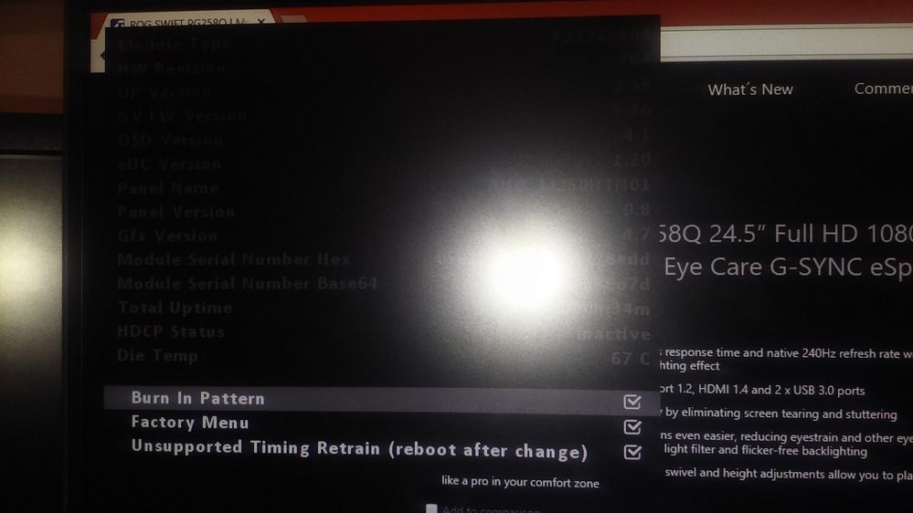

Sixth, a new menu appeared with information about the monitor and several options that were not there. I had not seen this menu before. I will post a picture below.

-I tried to deactivate the options on the factory menu that appeared, but it does not help, only hides the menu, but returns when another automatic factory reset occurs.
There is this weird menu that wasn't there before. I can access it after the monitor self-factory resets itself by pressing the fourth button from bottom to top:
68425
This is the error in the OSD menu:
68426

1# Open OSD Menu, GameVisual Racing Mode
2# Adjust Brightness 80->15, Contrast 50->42
3# Adjust color R=99 G=92 B=100
4# Press X button for Factory Menu
5# Uncheck Burn In Pattern (Disable burn in pattern until next power up)
6# Uncheck Factory menu (Restores X button to OSD Close button)
Now after more than 2-2½ years with this annoying problem i will never forget my calibrated settings and now i can calibrate my screen faster than windows can boot 🙂
