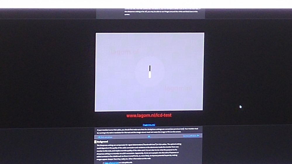

I think it pretty much does.
Here is a zoomed in photo from my cellphone, looks pretty much the same with my eyes and I have perfect uncorrected vision.
Keep in mind, this is like 5 meters away... Then I have wall, so I can't go further.
66751

Thank you so much for the reply and the photo. Test looks good.
I'm aware of the BLB issue, and have seen it on MG279Q (same or very similar AUO panel). That seemed to be caused by the panel being slightly twisted by the casing. Too bad that according to reviews the monitor is still being a lot of a lottery in this regard.
