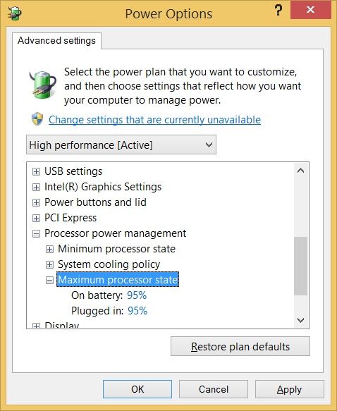

Not sure if it will make much difference, but don't see that you've tried to "set the maximum processor state from 100% to 95%" which is different than the sleep, shutdown, hibernate settings, so consider looking into that.
Change it for each power plan that you use, but below is a screenshot to give you a better idea of what's involved and please let me know if anything is unclear.
By the way wondering if you have updated to the Windows 10 Anniversary Edition yet and if it made things better or worse. Run 'winver' from the Windows 10 search bar to see if the version is 1607 for the Anniversary Edition.
