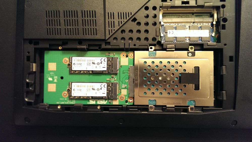

Hey. So I got a G750JZ-DS71 with an 250gb ssd. I had a 500 gb samsung SSD so the original plan was to just swap that out and give my daughter the smaller one. But when I opened it up, I have no idea what I'm looking at or how to take it out or if it can even come out.
Is anybody familiar with the hard drive in this thing and what it is? Is it upgradable at all if I want to go to 500gb or a TB at some point?

What you're most likely looking at is two MSata's in Raid configuration, attached to a daughterboard then linked to the motherboard. If you want an SSD in there, a full size 2.5", then you need to pull apart the laptop, take out the MSata daughter board, unplug it, and replace the connection with a dual Sata.
The dual sata is a whole different "part" that you need to replace in the hard drive bay. I do not know where you can buy it from, or how much it costs.
The laptop is difficult to disassemble.

Maybe you can take a picture of the actual SSD, so we can tell you which kind of SSD it is.

Here's an image of the drive. 42115

That's a RAID board with two M.2 SATA SSDs, Darnassus is right, if you want to have a 2.5" SSD you will need to replace the RAID board with a board with 2 "normal" SATA connectors.

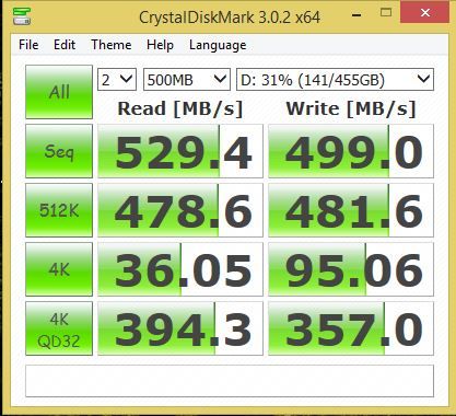

CrystalDiskMark results from my JH (predecessor to the JZ) with RAID0 2 x 128GB M.2 SATA drives - just like yours:

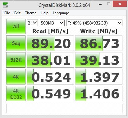

Here is what a single 2.5" Samsung 840 Pro 512GB gets in the 2nd Bay of the JH:
42117
Even the fastest SSD can only go as fast as 1 SATA III port, but 2 SATA III ports in a RAID0 can go up to 2x as fast.
The 2 x 128GB M.2 SATA SSD speed is good, but they aren't the fastest M.2 SATA cards available.
Put in a couple of Crucial M550 512GB's in a RAID0 configuration and get 2x the single SATA III speed.

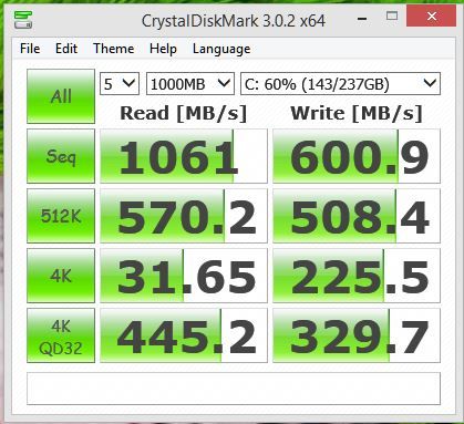

Here is what my 1TB performance looks like in an external USB 3.0 enclosure, hardly worth using, compared to even a single SSD throughput:
42118

Yeah, that's actually what I was going to look into. It looked like they were removable. I just couldn't find any identification on them to see what they are to know what to search for. It already seems like this thing is way faster than my last computer with the SSD in it. I know part of it is windows 8 but this thing turns on nearly instantly It's hard to tell the difference between a power down and sleep. So I'd rather not loose that. Suppose I am going to need a whole new set of equipment now though to clone a drive.
I avoided raid 0 up to now because while it's 2X the speed it's also 2X the failure points and I didn't want to loose any work I may be doing on the thing, but this is hard to go back from.
