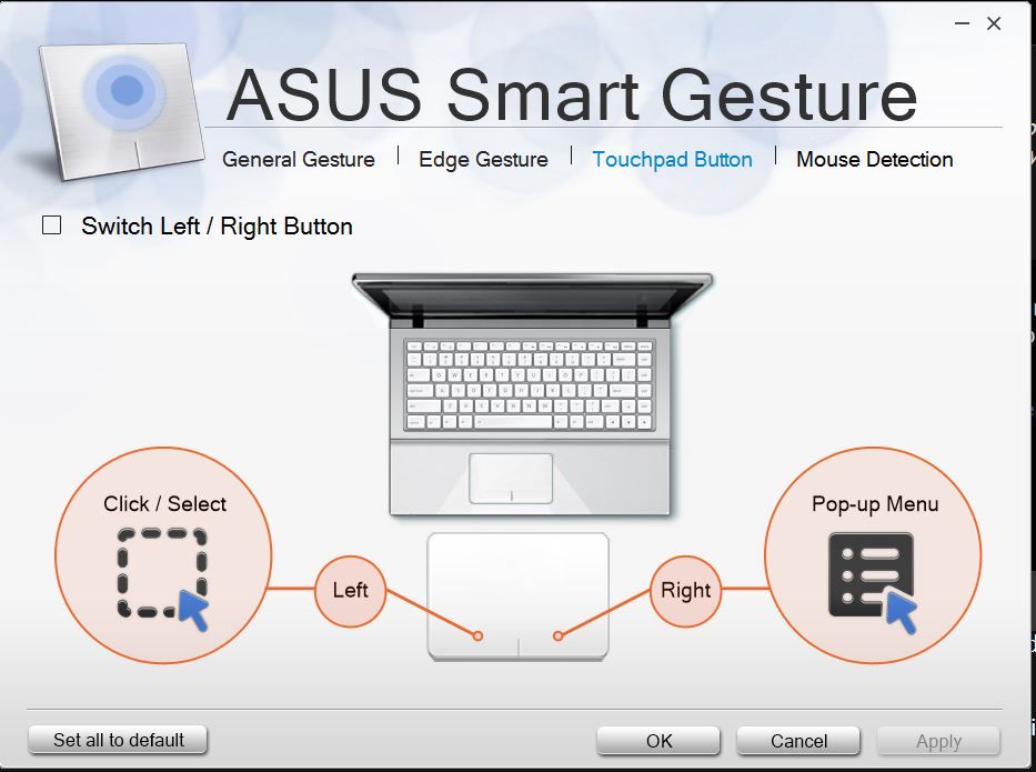

Did you check to see if one of the options in the Asus Smart Gestures got unchecked?

I disconnected the mouse it still didn't work i checked the asus smart gesture no changes i had not installed anything since or before it started to stop working. it does not do anything it's like there is no button being hit.

You could try swapping right/left functions with Smart Gesture and see if the left button can activate the right click function, and see if the "broken" right button can activate left click - that would isolate the problem to a physical button problem vs a strange avoidance of supporting right click function.

You could also try swapping right/left functions with Smart Gesture and see if the left button can activate the right click function, and see if the "broken" right button can activate left click - that would isolate the problem to a physical button problem vs a strange avoidance of supporting right click function.

yeah i tried this it means that the right button is not working.
