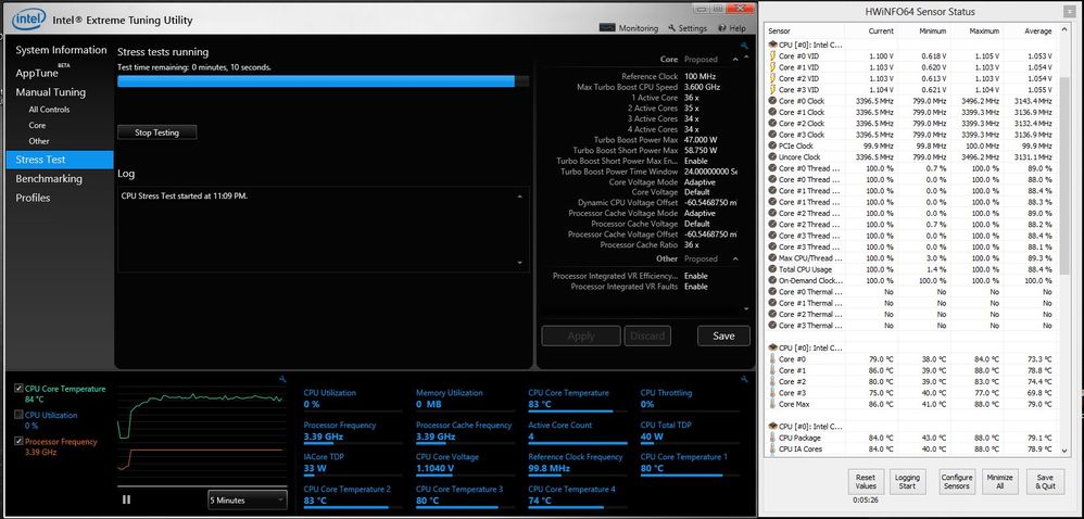

Here is the 5 minute XTU stress test run with max OC and -60mv CPU/cache offset, room temperature was 72.5'F
27544
Here is the 5 minute XTU stress test run with stock settings, room temp was 72.8'F
27545
Neither test had thermal throttling, and both tests had much lower temperatures than your's.
