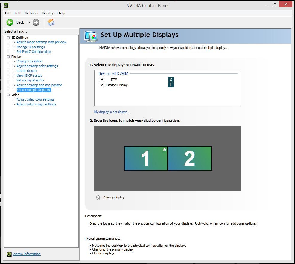

When you open the Nvidia Control panel, and go to the Set up Multiple Displays panel, do you see 2 monitors when you have the TV HDMI connected and the TV powered up on the input from the PC?
37413

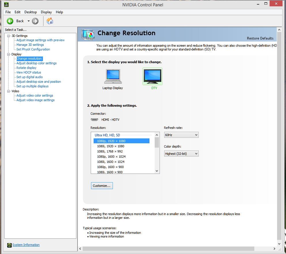

Do you see 2 monitors in the Nvidia Control panel Change Resolution panel?
37414
