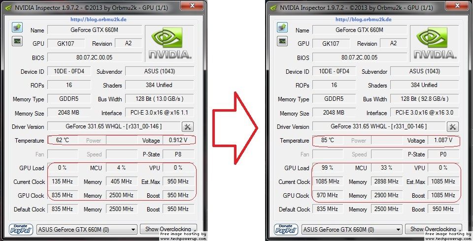

i tried it today. i set the core clock to 1010 using the target line. i noticed that in the nvidia inspector, only the current clock line shows the 1010 value. the other two beneath it, gpu clock and default clock, show the base 835 value. does it mean that the trick still works?
i ask because when i increase the core clock by moving the slider +135 in nvidia inspector, the current and default clock remain at 835, and the gpu clock is the one that increases.
someone from another forum told me that if the current clock shows the gpu clock value that was set in the Target line, it means that the trick still works! 😄
what is the recommended max value for the gpu clcok on the 660m? i know that max frecommended for memory is 400 ....

Try this overclock.bat
nvidiaInspector.exe -forcepstate:0,0 -setGpuClock:0,2,1000 -setMemoryClock:0,2,2950
Try this to reset everything
nvidiaInspector.exe -setVoltageOffset:0,0,0 -setGpuClock:0,2,835 -setMemoryClock:0,2,2500 -forcepstate:0,16

When it worked for me i had my clocks like this: Core clock - 1300 with the boost, Memory clock - 3000

Nice GPU core overclock. Memory you can definitely try 3000mhz.
how to do that?
i just reach 90 degree heat while im playing crysis2..is that going to be ok if i keep playing and use my oc?
arnold315 wrote:
how to do that?
Wow anything over 85degC is probably ~not~ a good idea. Try to OC accordingly so max 85degC. Mem clock you can push to 3000mhz as that AFAIK doesn't affect GPU core temp much 🙂
