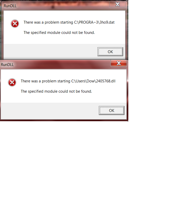

Another error I get every time I boot up recently also is this...
Do these have anything to do with my issues?

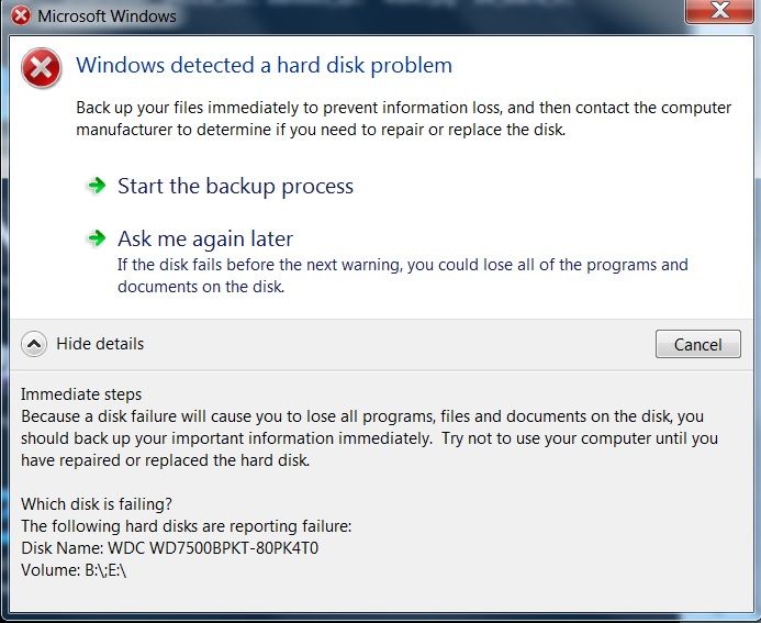

I still haven't had a chance to do the clean install since I've been really busy and everything seemed to be working fine. But today I got this message. Does it definitely mean my hard drive is bad and I should send it back? Anything I can do?
I just started summer classes, if I have to send it to the manufacturer I'll likely fail and lose my student aid for good. So I need to avoid that.
Please help me out asap.

So I am assuming you haven't done anything so far other than backup some important files to your external hdd, right?
I am also assuming your Windows message is about your 750 GB hdd, not your C: System drive SSD, right?
You also have said you have a 500 GB external hdd, as well as a copy of Acronis, right?
How much data space is used on the SSD? Fill in the blank: __________ of 256 GB is used
How much data space is used on the hdd? Fill in the blank: __________ of 750 GB is used

Your error messages might not be fatal YET. I would try to image the drive to your external hdd, then put a new blank hdd in the laptop and restore the image. See if that works ok then. Follow the Acronis instructions. Try to run the backup image under cool conditions in case excessive heat is causing the hdd failure.

If you can fit all your data on it, try removing the 750 GB drive and putting the new 500 GB drive in its place. If this solves the problem, you can hold off on sending your laptop in until a better time. This thread will provide proof of the date of issue, and your notes about schoolwork can provide reason for ASUS to service your notebook even if it were to go out of warranty. If replacing the HDD is the only issue, then you might be able to talk them into trying to hurry your notebook through the service process, since you need it for school.
