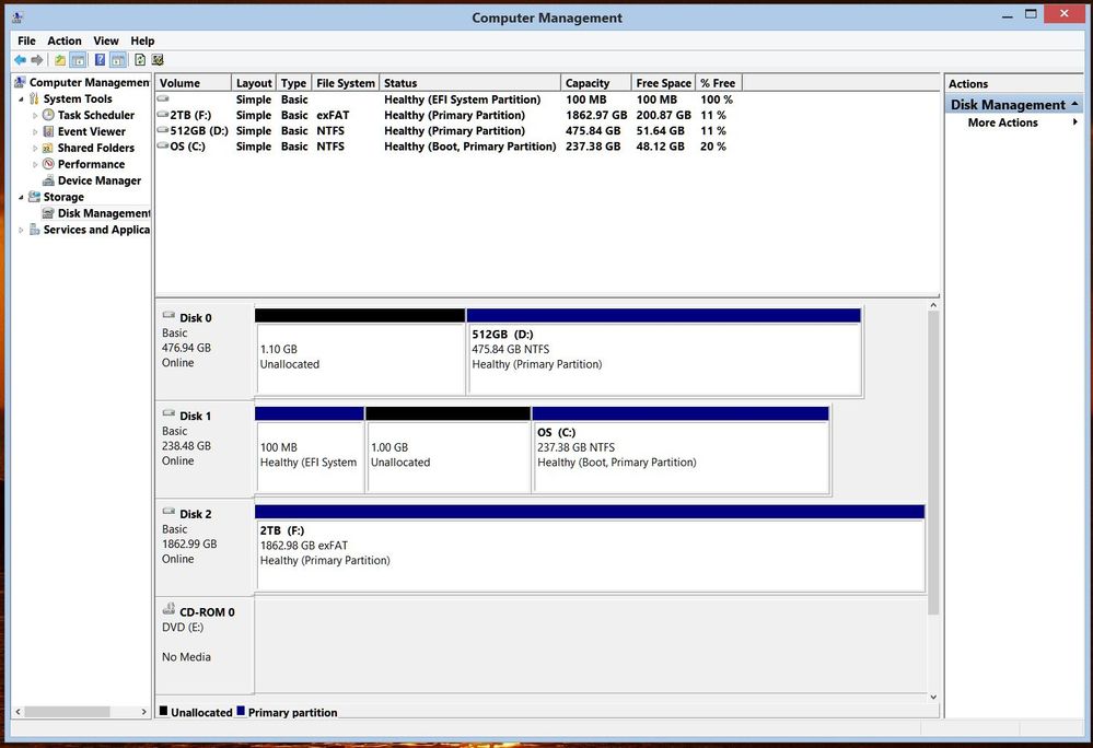

katim2004, right click on the Desktop Computer icon, Manage, drill down to the Storage Manager, you should see the raw drive, right click and create a New Simple Volume => ntfs partition.
47393
47393
ty hmscott but i told u i cant even find it in device manager or in disk mnager , its like it doesn't exist .
anyway i solved the problem , i dont now how XD just finished windows update , updated my BIOS and its solved after the restart
