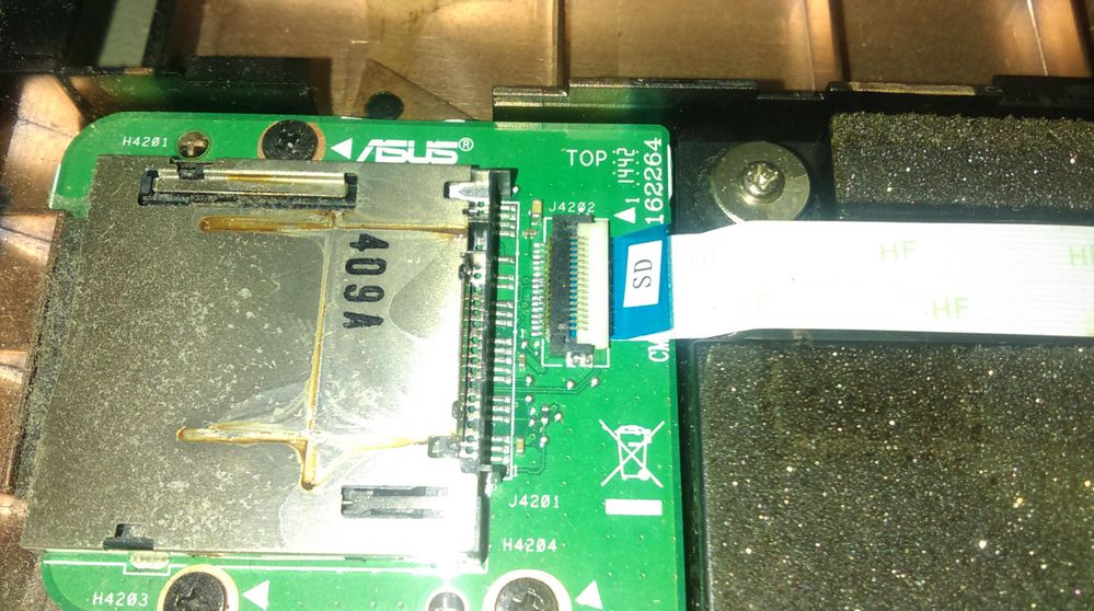

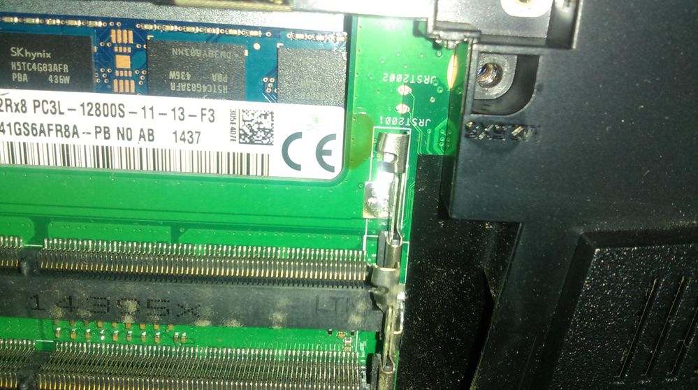

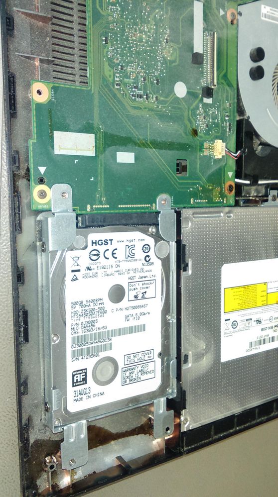

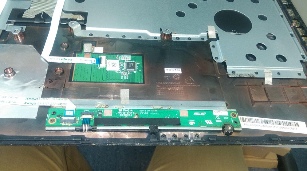

So I asked the technicians at the service to send me some photos so I can see exactly how the components were damaged. I will attatch the photos here below. Question: on the 1st photo with the hard disk, why does it say 500GB with 5400 RPM? I have a 1TB HDD with 7200 RPM.

Drunkenninja
I repaired consoles and laptops, even car electronics in the past and I will give you my recommendation. 1st thing I will say is when spilling liquid on electronics turn it off immediately, the liquid causes no harm to the Laptop, it's how the liquid conducts the electricity to other board components that can cause the most serious damage, a small blown capacitor may seem like nothing but when there are thousands of capacitors on a board, good luck finding the one blown when each must be tested off the board.
The others are right the service centre is definitely tying to rip you off, its's almost impossible for all those components to be effected!!!
What you need to do is flush the motherboard with Standard Thinners, It's more aggressive than alcohol, i'm not a fan of alcohol unless its 100% cause your putting anything from 1% water on the board if not, it also doesn't clean very well in comparison with more aggressive substances like thinners or MEK. (IF YOU USE THINNERS OR MEK ONLY PUT THIS ON THE MOTHERBOARD, IT WILL MELT PLATICS LIKE THE KEYBOARD OR TOUCHPAD - Componants that appear plastic on the Motherboard are fine they are resistant) If you can find a repair shop with a ultrasonic cleaner (a large one that fits a laptop motherboard) I would pay for a simple cleaning cause that's stage 1 of any liquid damage repair sorted.
After you clean the board it should be left in a well ventilated area for between 24-48 hours in an upside down or side ways, position, as others suggested you can then start rebuilding the laptop adding conponants by elimination, use a usb keyboard and mouse for example in your 1st test.
Hope it helps, and steer clear of that centre, I bet there are some great repair centres online if you can send the board abroad, have a sniff around. Some of those marks in your images may be glue, I have opened hundreds of machines with marks like those that have never been subject to liquid damage, start by eliminating the keyboard they hate liquid damage.
blueyurble
And what about the inscription on the HDD? Why does it say 500 GB with 5400 RPM when I have 1TB with 7200 RPM? I need to know if this is normal because otherwise I need to argue with them at the service center to give my HDD back!
joshindaphils
Level 11
That first pic is not your laptop, it is not a G751. Check my disassembly thread for a comparison: https://rog.asus.com/forum/showthread.php?59354-G751JY-Disassembly-Pics
blueyurble
Oh, God. What about the other pics? Do they look like a G751JT to you? Thank you kind sir for the fast response.
joshindaphils
Level 11
You can reference the pics in the link I posted for yourself. It is quite evident.
The second pic is not a G751 keyboard assembly... The others are all clearly pics of a G751.
This could very well be a legitimate mistake as there are two images of a keyboard assembly one unknown one a G751, if the goal was to con you it would be a very poor attempt.
