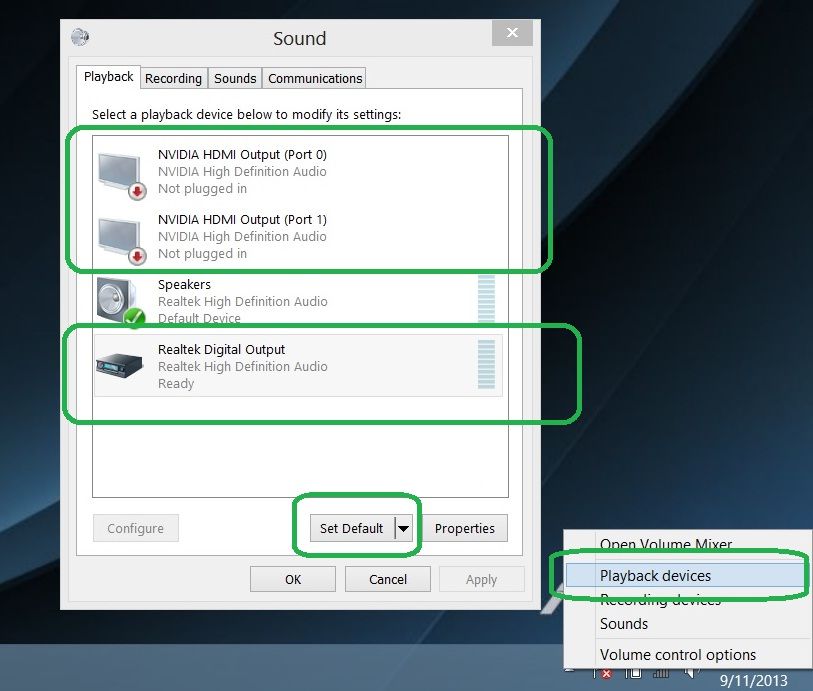

If you haven't tried this to get your HDMI audio working, right click your desktop taskbar speaker icon to choose playback devices and set the nVIdia HDMI or Realtek Digital output as the default device as in the screenshot below (If it matters, I didn't have a TV hooked up when I took this screenshot).
You might also want to check and update your audio drivers.
Hope this helps!

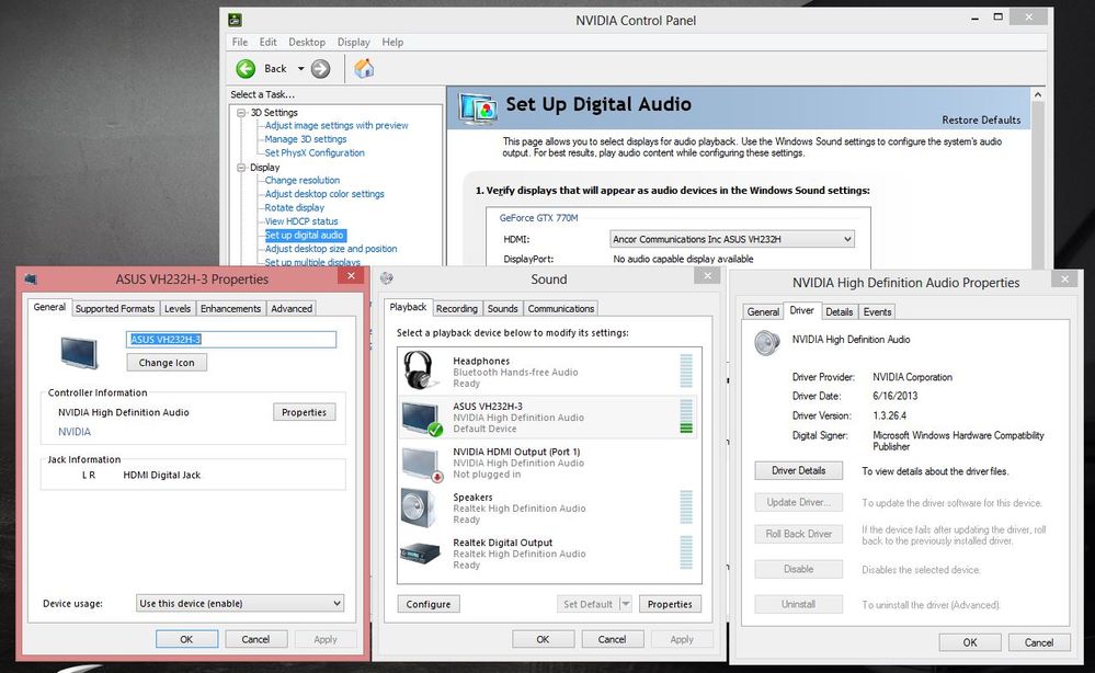

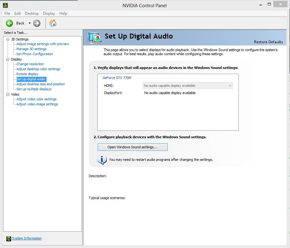

Also check the Nvidia Control Panel Digital Audio setup

Here is what it should look like when it is working:
26229
When I plugged in the HDMI cable to the powered on monitor, the device became immediately available, and as soon as I selected it and clicked Set Default the audio came out of the display.
