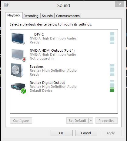

I've bought a Asus Notebook (G750JX - a pretty good one) to mainly play games and do some music editing with MIDI.
The sound through the internal speakers come out great. Really loud and clear. But, unfortunately, any music editing software I install in it, it automatically sets to use the REALTEK DIGITAL OUTPUT as standard output.
But, the REALTEK DIGITAL OUTPUT doesn't come out through the internal speakers! So I have no idea how to use any software that goes directly for that output!

Did you try disabling Realtek Digital Output in the Sound Settings under Playback Devices in the Control Panel?

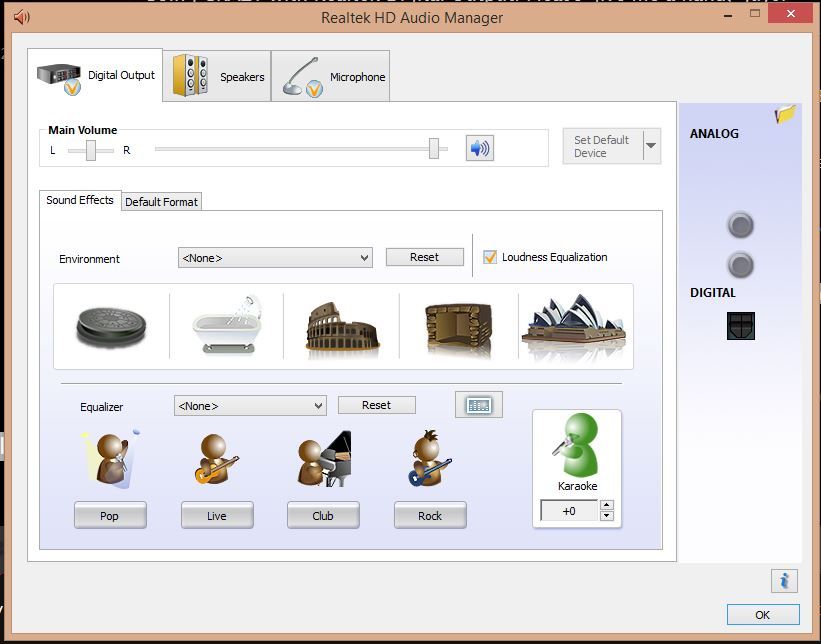

It comes out the Headphone jack 🙂
It is a Toslink optical feed. I use an adapter to connect to my Sennheiser RS-220 wireless headphones.
When I finally get a chance to hook it up to a receiver I will update with info about Surround sound modes, but right now I only use Stereo.

Audio coming out the headphones jack is High Impedance analog audio - like any other headphone jack.
Until you plug in a Toslink adapter into the headphones jack, and a Toslink cable to a Toslink optical input on a device that will take the signal and decode it to feed it to speakers, headphones, or wireless audio device, then you are using digital audio fed from the optical output hidden in the headphones jack.
Toslink Optical isn't really complex, but it takes more equipment than just using stereo headphones plugged in, or taking that audio out to a stereo amplifier to feed speakers.
You want to use high impedance headphones in the G750 headphones jack, as low impedance like Apple Ear buds, or other 16/32 ohm headphones may show amplifier hiss. Try to get > 150 ohm headphones to avoid that. I think 300 or 600 ohm have been reported as best.
I use my Sony MDR-XB500's 40 ohm headphones, and I don't hear any hiss, but I prefer the sound of my Sennheiser RS-220's, and only use the MDR-500's when I am using the RS-220's elsewhere.
You need to tell us what you have that has an optical Toslink input that you can feed from the G750 Toslink output. Or, you will need to buy something that has a Toslink optical input before you can use the G750's Toslink optical output.
