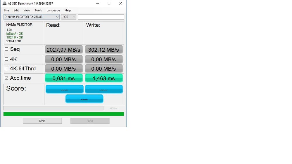

After few days i benchmarked my SSD, result were bad - mainly WRITE ops. ATTO benchmarks looked ok, but
CDM, AS SSD, Anvil very bad. My first thought was that there is sth wrong with this disk so i have returned it and
hardware store i bought it from i accepted it after runnig some "diagnosis". I bought another one exactly same model.
Unfortunately same problem occured with regard to its performance. This time tried to do some shenanigans, install/uninstall win10, install/unistall IRST, benchamrk it with OS/ wo OS. I have even managed to run it under RAID mode, but it didnt help either,
it was even slower, but i guess it was due to inferior driver (iaSTORa). I have also tried downgrading BIOS to 214. Didnt change anything. Then i noticed this SSD is running very high temp.(67-75) even when idle. So i came to conclusion that this might be the issue and decided to return it again and try different brand. Today i bought Plextor M8pe(G) 256GB.
Unfortunately same issues or even worse. With Patriot in AHCI mode i could see a NVME Configuration menu entry in BIOS, but
for Plextor there is none. Win10 detects it, installs driver, but it is see as "removable drive" even thought AS SSD shows it is using stornvme driver. Test results in CDM seems "OK", but in AS SSD/Anvil are very bad - with regard to WRITE ops.

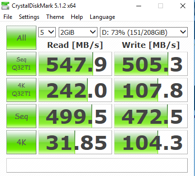

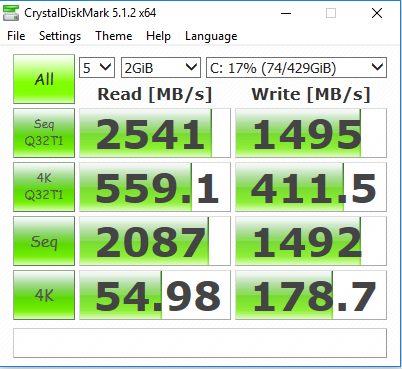

Can you try benchmark using crystaldisk and post results so that we can compare results?
I also have a G752VT and here is my result.
Samsung 950 PRO:
62295
By comparison, Samsung 850 EVO:
62296

Update: I did try installing win10 on NVME (RAID mode), but wasnt detected. I have tried installing Intel RAID controller, but go bluescreen (iaStorAV.sys failed). If i tried installing Windows\System32\DriverStore\FileRepository\stornvme.inf_amd64_81abc12481a950f2, it doesnt detect any compatible hardware. Are you sure i should try to run it under RAID mode ? I did little trick with win10 safe to switch my current installation to RAID mode - it worked, but now NVME is not even detected in win10. I try "Scan for hardware changes", but nothing is found. Any ideas ?
Update2: Ok, i guess i forgot to install Intel Rapid Storage Driver. After that, NVME showed up, but similarly to my Patriot experience, it runs on
iaStorA.sys driver. On READ-side performance is the same but WRITE is even worse. Like i wrote, with CDM i had "ok" results (under AHCI mode and as secondary storage), but now even CDM shows bad results. Do i need to try to force-install stronvme.sys somehow ?
Update3: Ok, bad performance in CDM was due to disabled "Write cache policy" - manufacturer recomends to enable it. But performance in AS SS is still bad:
62322
So to summarize, i would say nothing to little has changed in terms of performance in AS SSD. In terms of compatibility, i cant install win10 - maybe i need to try different build version of this driver? And now (in RAID mode) CrystalDiskInfo doesnt detect my NVME completely. Plextool also doesnt detect it.

ASSD has an issue with NVMe drives. Crystal Diskmark works much better. Just be prepared that you won't see the same results as the Samsung drives. They are top of the heap in NVMe.
Ive run my G752VY with 950 pros as single with both raid enabled and disabled, no discernible difference. I have fast boot disabled as well as CSM disabled with a UEFI install. I have two 512GBs. Now running raid zero which only offers a small improvement in sequential read but doubles sequential writes. *

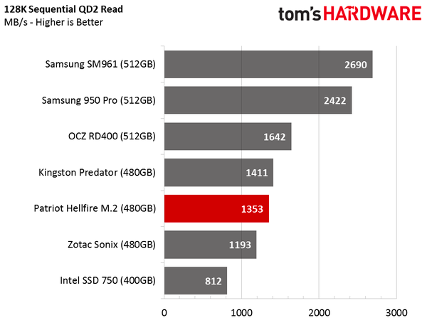

I'm afraid where your problem lies is with selection of the SSD. It's better than a SATA SSD but is nowhere close to Samsung, not even in the same ballpark. It's about half the speed. Here's the results for Toms review comparisons. Hellfire is near the bottom.*
62344*

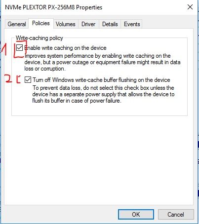

Mystery Solved !!!
It turns out it had nothing to do with BIOS mode or anything like it. Disk drive "write caching policy" is making huge difference for this technology:
62348
When disabled option 1. (effectively ALL) even CDM results were very BAD. This is described on manufacturer's website.
Enabling 2. option made results with AS SSD and Anvil OK.
