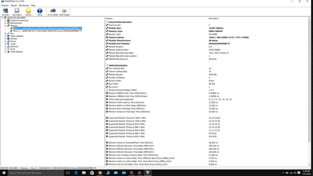

Download Hwinfo and run it. It will tell you what ram you have as well as everything else for that matter.

The HW info tell you EVERYTHING you need to know about the ram, including the manufacturer and model number, even the serial number. It just leave you with no questions. My guess is you have a single 8GB stick and and can upgrade to 24GB but cant tell with a certainty by the info provided.
Here is an example of the HWinfo. Shows mine with 2x16GB sticks, clocks, timing, latency etc. so you can buy something that is compatible with what you already have in it if you are not prepared to remove it.
