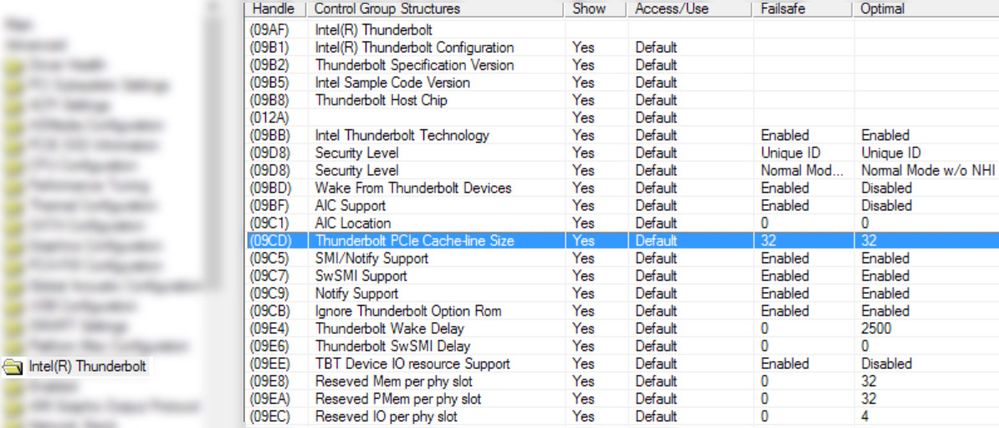

There are a lot of parameters to take in when talking about the speed of W and R through TB.
1st of all @Jon G - how did you deduct that on the G751 serie TB is 4Gb/s ( i.e bits not bytes ) ?
2nd, AFAIK the G751 got 1st Gen TB, which suppose to give 10Gb/s NOT 20Gb/s as TB Gen 2 (aka Falcon Ridge) suppose to give ( according to this review )
there might be parameters within the driver ( through device manager ) that can be changed like "Override 1st device in chain restriction" which might effect transfer speed.
Also as stated in the mentioned review and I quote:
"I recommend doing is setting theCache-line size to 128 as it seems to affect performance by a fair margin."
Thus, if current bios not allows to play with "Cache-line size" value->a modded bios might give you that ability, as you can see that it is possible to toggle the appearance of "cache-line size" ( at least for the G751JT BIOS which I show in the end of this post ).
There is also another BIOS parameter that might effect external storage behavior like stated HERE under # 177,178 named "TB device i/o resource support", which also appears in the bios's hidden menus.
