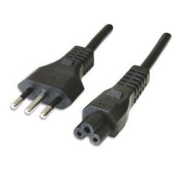

55746
Sorry, but this one is Type L and it's used almost exclusively in Italy and Chile.
If the 2 pin plug is Type F (used anywhere in Europe and Russia) then it is a grounded one.

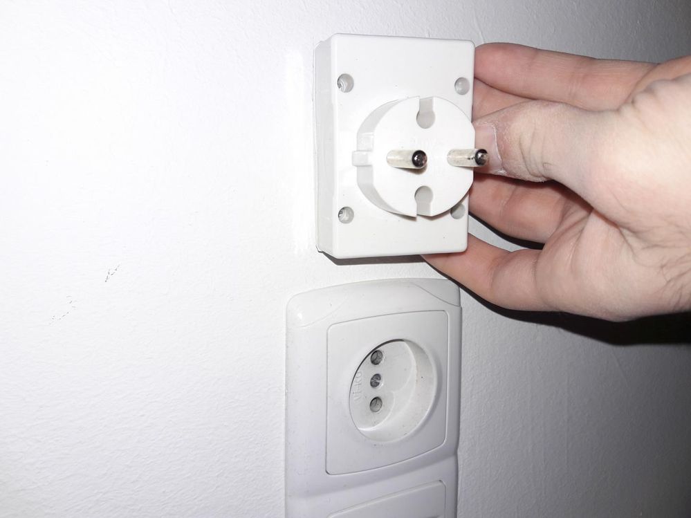

i live in georgia(not state) and we have these types of sockets and plugs here, and i wonder if there are some kind of adapter to also ground.
55748
55748
According to your photo you don't have ground cable in the wall. The 2 ways are to replace wall plug or buy an UPS .

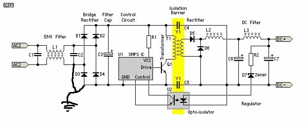

JustinThyme
Level 13
Flip the plug 180 in the socket, you have reversed polarity, hot where neutral should be and vice versa.
Three prongs on laptop power supplies is a relatively new thing. I still have a bunch laying around without it. Couldnt find a schematic with the ground but penciled it in, you can see where the buzz comes from, Top input shoud be hot and bottom neutral.
55752
