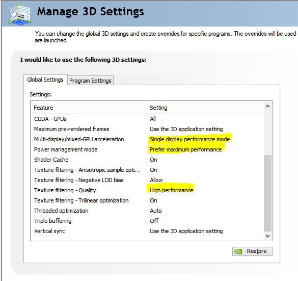

Same goes for Custom=> Clean installs of Nvidia drivers, your 3D performance settings get reset to default - and they default to power saving modes:
Check to make sure your 3D global settings are being used:
45560
Check to make sure your 3D Global performance settings are set:
45561

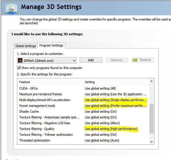

And, make sure any game/app specific settings are set:
45562
If you are still getting glitches, it might be game specific and need a specific tuning fix for that game. A number of new games have come out with performance issues that are bad even on high end desktop systems, it might take a few months of patching to solve them.
