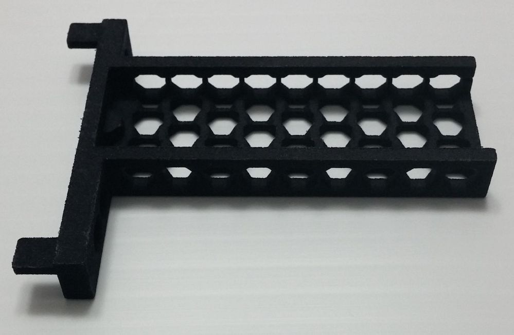

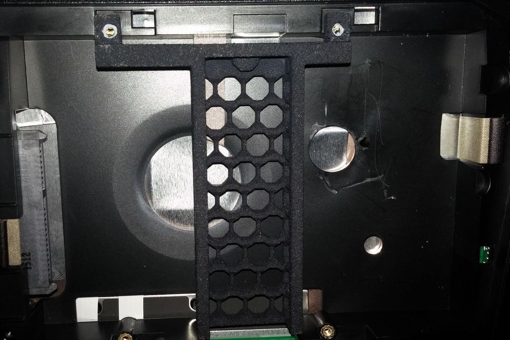

After searching these forums for a M.2 bracket for my G751JY-DB73X G-Sync I actually made a 3d printed M.2 bracket myself. Well i made 13 versions before i found one that was perfect but its on shapeways if anyone still needs one. It has an open top for heatsinks. It also leaves enough room for the 850 EVO to fit naked. With heatsinks attached i got an average 7 degree drop in crystaldiskmark with the SM951 and 11 degrees with the stock XP941 which is a lot more then i expected.
UPDATED NEW M.2 VERSIONS
Need to drill holes yourself but the cleanest option-
http://shpws.me/J8lX
preprinted holes but wont look as clean-
http://shpws.me/JcEy
installing a drive larger than the evo 250gb in bay 1 without heatsinks-
http://shpws.me/JtUm
installing a drive larger than the evo 250gb in bay 1 with heatsinks (use another version if you can)-
http://shpws.me/J
link to all brackets
https://www.shapeways.com/shops/aeolisio

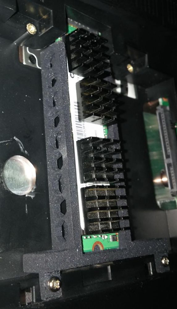

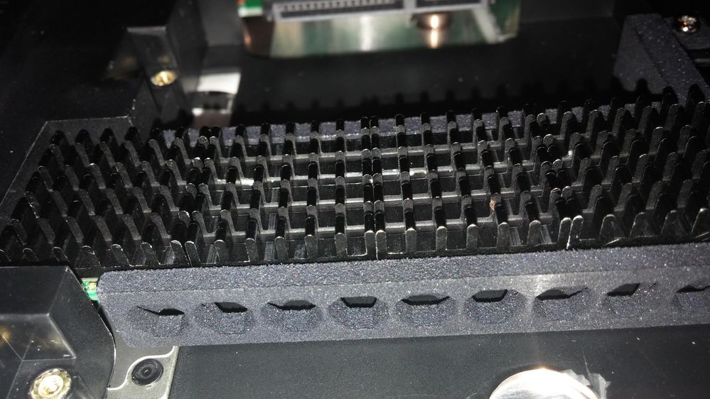

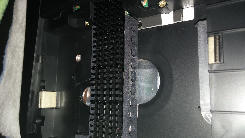

I realized i never posted pics with the 19mm heatsinks they fit almost seamlessly. Cant beat $1.19 plus the price of thermal pads
51497
51496
Heres the ebay link if anyone needs them.

10mm for height is too tall 7mm will fit but hit the cover and could transfer heat to the plastic 5mm doesnt touch anything verified with toner paper. 20mm width will fit but will make contact with the bracket itself and even though the bracket will be almost exactly 20mm most 20mm heatsinks vary in dimensions as much as 1mm and 21mm will not fit. The tolerances of the design are very tight there is no room for a 1mm variance.
3mm is the max height for lower heatsinks under the m.2 but that only applies to 512 and higher capacities.
Be careful with those preapplied adhesive heatsinks like that one that is just adhesive tape not thermal tape and will transfer very little heat to the heatsink. I also gently removed the oem stickers and stuck them to a piece of wax paper for safekeeping if i needed to reapply for warranty but you can apply the heatsink on top of the sticker if you want.
