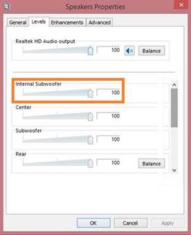

  • At least v7095 (for the G750JH/JX) of the Audio Drivers had a Subwoofer Volume slider located on the Realtek Audio Manager. (As shown below)
Drivers Uninstalled - Subwoofer & Speakers Seperated
This can be used to find out the hardware ID of each component, and tweak the driver to send the correct signal to each. Simply uninstall the realtek drivers on your machine and reboot - windows will install its own drivers and separate the two speakers. From there, you can find out their hardware IDs and use that to help in tweaking the signal to each component.
Audio Driver v7095 Installed on a G750JH (Subwoofer Volume Slider does not show up on G751)

Just FYI - this is the proposed UI addition from our RD. Seems it's what you need. 😉
45406
45406
As long as it works and doesn't control all speakers (like "Front" does currently, from the same window) we'll be happy with that - it will let us manually balance the subwoofer with the back speakers.
Will it auto scale to the volume level? 25% Speaker Volume = 10% Subwoofer Volume -> 50% Speaker = 20% Subwoofer -> 100% Speaker = 40% Subwoofer?
