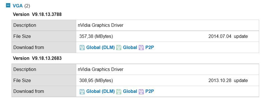

...somebody tried new ASUS driver released 2014.07.04 on ASUS G750JW download site (Version V9.18.13.3788 )?
Dario723, nice find 🙂
38715
G750JW
http://dlcdnet.asus.com/pub/ASUS/nb/DriversForWin8.1/VGA/VGA_nVidia_Verde_Win81_64_VER918133788.zip
Someone else mentioned this in another thread, but didn't say where they found it, a Verde driver - point release with fixes for specific hardware - he thought it was for the JS model.
38716
And, it's also downloadable from the JS download area, the same source download location:
I am running 340.43, and don't have the auto contrast bug... so someone else will have to try nVidia_Verde_Win81_64_VER918133788 🙂
..tried it ...driving me crazy!@#$%^&*...doesn't work, clean install, still dimming at AC, uhhh....at the moment it's the only flaw with my G750JW, the rest is quite close to perfect ...
