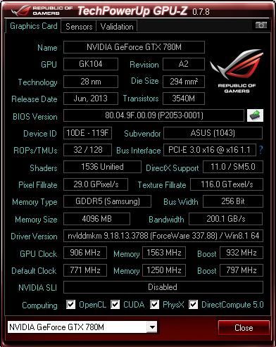

You can check the vbios version on your JX using TechPowerup GPU-Z, mine is a JH, but here is an example - it shows the video bios (and lets you back up the video bios, little chip icon to the right of the version box), and lots of other info.
37244
You can give that GPU-Z info, as text and attach the jpg image to the Technical Inquiry, to Asus and ask Asus if there is an updated vbios that they can give you to update, and explain the problem - ask them for help (I don't recall if you already did that).
