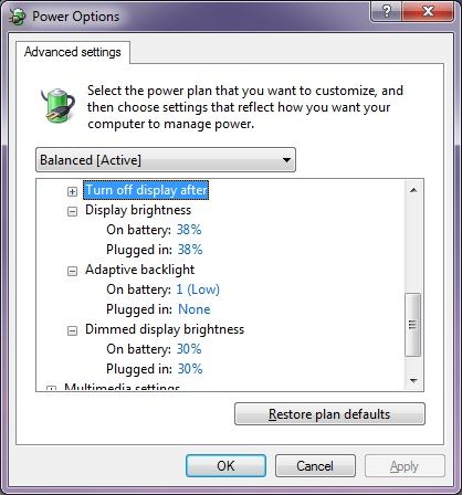

FYI, just checked the regsitry entries mentioned above.
my windows 8.1 has the folders with some entries in (although i dont have the brightness problems).
my windows 7, using all the same drivers, has the folders but they are empty.
is it a windows 8 'feature' ?
oh, and its 'changed' from windows 7 (nice one micro$oft)
adaptive backlight i have the choice of none, 1 low to 5 high.
