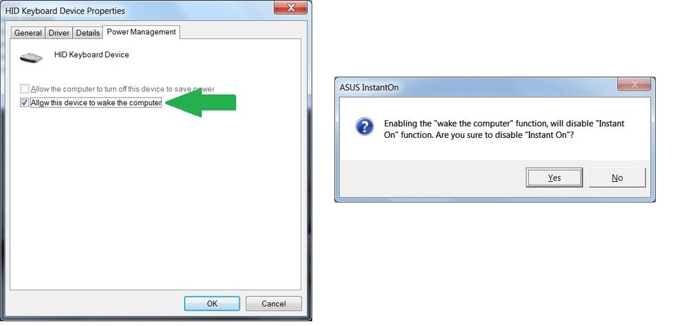

If you haven't tried it, check under device manager for the (USB?) keyboard and mouse properties for a Power Management tab and option to 'Allow this device to wake the computer' as in the screenshot below (left side).
My Win7 G75VW test unit still didn't wake from external USB keyboard the first time after changing this setting, but a message appeared about disabling InstantOn as in the screenshot below after waking up using the power button (right side).
Disabling InstantOn solved the problem and allowed the external USB keyboard to wake up the system the next time the notebook went to sleep.
If you can disable InstantOn, I'm guessing it may also help with that lid switch setting problem too.
