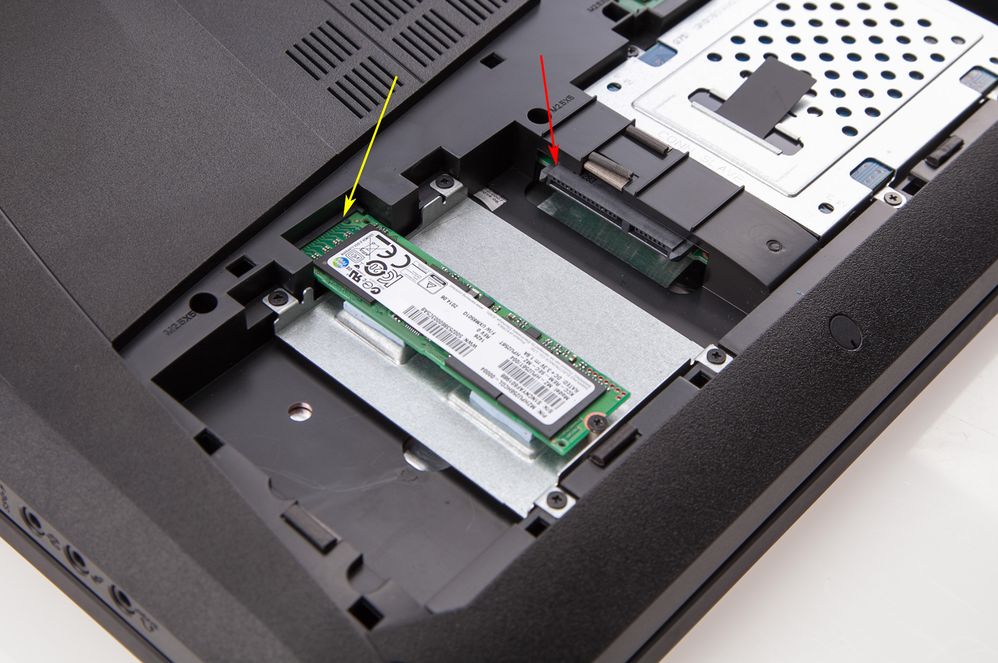

The primary side where the M2 slot would be if you have one would be on the left as you are looking at bottom up with the service cover removed.
In this borrowed image the Yellow image shows the M2, Red shows the SATA III. the other side is SATA II.
58520
A lot of folks put an M2 in, nothing says you have to use a 128GB, 512 GB SM951s are readily available. As far as space is concerned a lot of people put the M2 in, remove the 850 Pro from the case and mount it on top of the M2. In my opinion no amount of space is going to make up for the difference in speed.
58520
