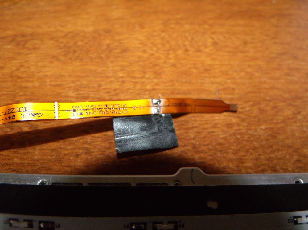

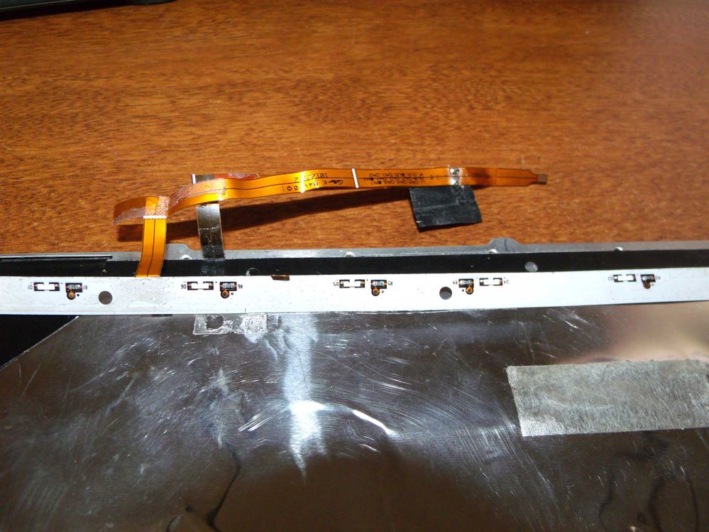

The first 2 pictures are showing where I tapped the power from the Keyboard backlight ribbon cable. The top trace is the +. The trick on soldering a ribbon cable is to keep the solder joints as low profile as possible.
19895
19896

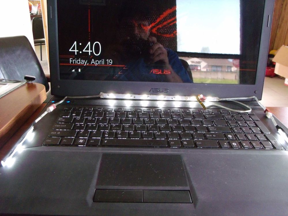

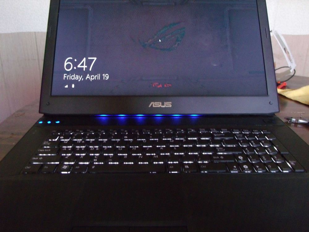

This picture is the first test if the keyboard backlight could handle 2 sets of backlights. It had no issues to the mod is on.
19897

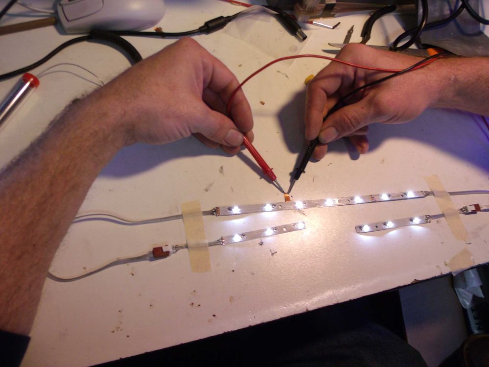

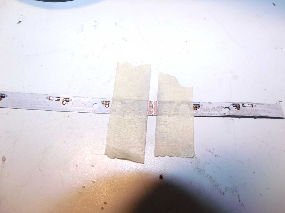

I actually ending up adding more LED's, by splicing a extra section of LED's from a 3rd set of Keyboard backlights. This requires some very delicate soldering.
19898

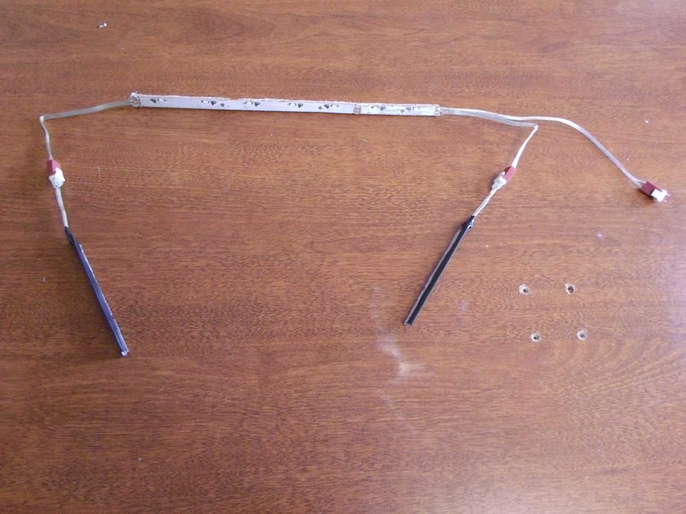

So after allot of soldering, some wires and plugs. I ended up with this. You can see the 2 smaller sections have plugs, they are for the exhaust vents. I added the plugs so the install would be easier plus if I need to take the laptop apart again it can come out in parts.

Here is the final LED strips. I attached the rows of LED's to some clear plastic for mounting.

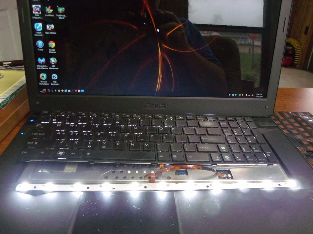

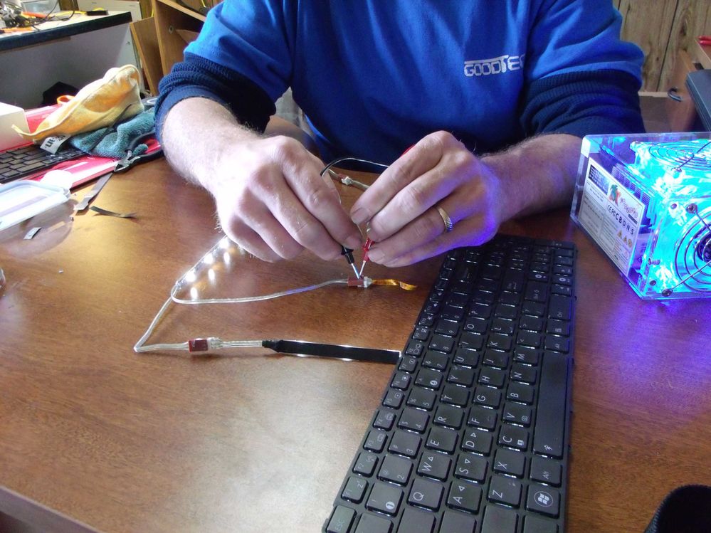

Here is the first test of the new LED parts attached to my keyboard. I used the 3.5V line from a desktop PSU for this test. I did this to make sure there was no shorts before I installed it in to my G73.
19901

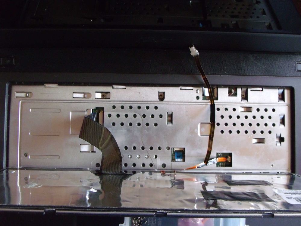

This is a picture of how I routed the power from the Keyboard backlight ribbon cable. It will go in though that hold that you can see the power button ribbon cable.
19908

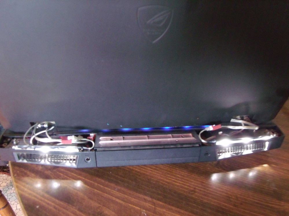

Here is the Afterburner LED's installed. You can see my plugs and wires.
19904
