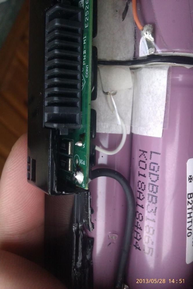

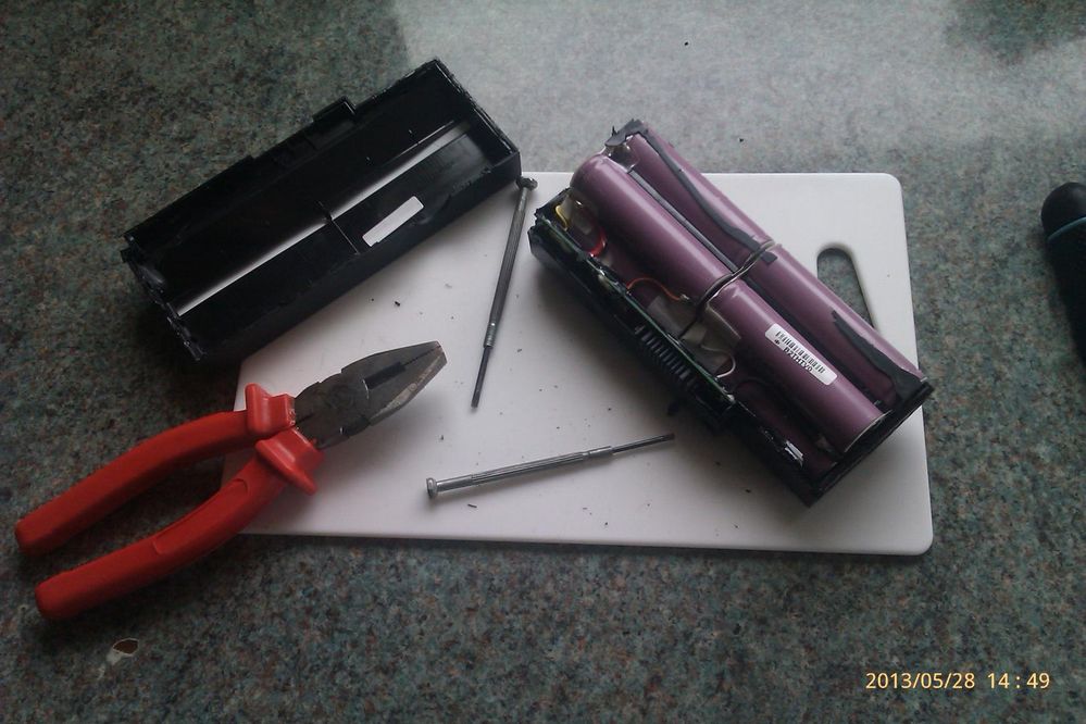

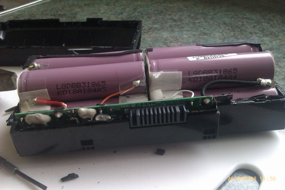

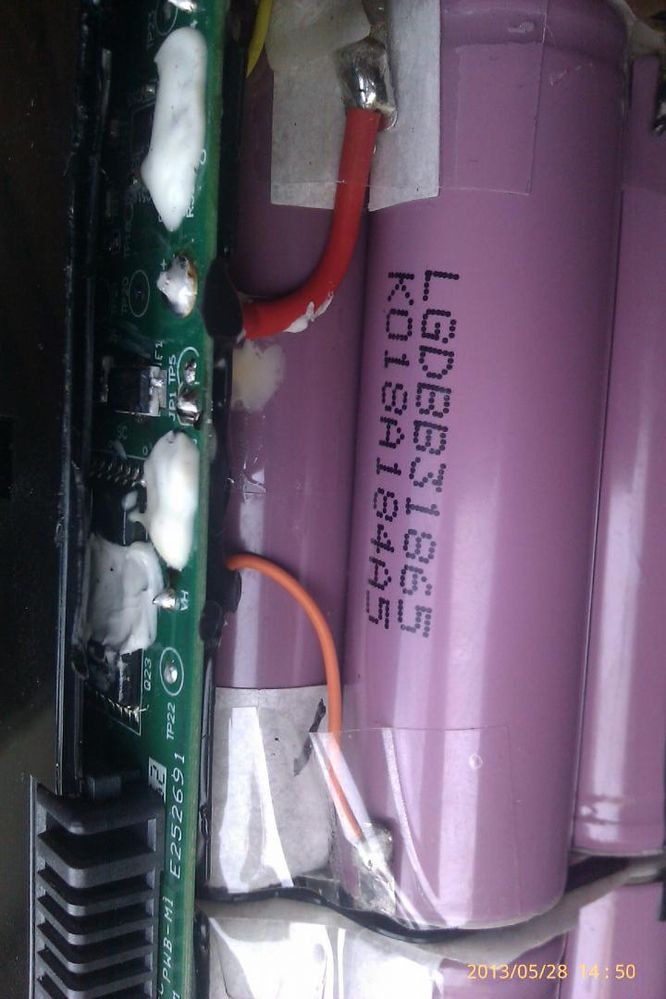

I already ordered a new battery from amazon.co.uk but in the waiting I was too curious not to open the (perhaps) damaged one in order to spot something blown or burnt in its internal circuit.
The battery pack is still giving 14.6V.
I wanted to share with you all theese pics.
