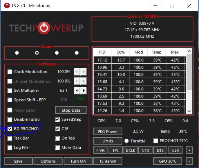

Troubleshooting the thread below for laggy G731GW, found out my CPU works only at 800 MHz. Nothing in the world - software, game or test tool is able to make it move. Multiple times reflashed BIOS, disconnected battery, checked performance settings and nothing helps. Any ideas anybody?
EDIT: ThrottleStop unlocked the multiplier.

New question. Is it supposed to work with unlocked BD PROCHOT or this unlocking only overpasses some fault, like a faulty motherboard sensor or faulty firmware.
unclewebb
Level 10
A sensor went bad, probably on your motherboard. This sensor is permanently sending a throttling signal to your CPU using the BD PROCHOT signal path. Disabling BD PROCHOT in ThrottleStop is preventing your CPU from getting these signals. That allows your CPU to run at its full rated speed like it should. If your CPU ever gets too hot (processor hot), the PROCHOT signal will go active and your CPU will thermal throttle to protect itself. PROCHOT and BD PROCHOT look the same but are two different things. They both use the same throttling mechanism within the CPU but are separate. Disabling BD PROCHOT does not interfere with the CPU thermal throttling when it gets too hot.
Without being an engineer with a thorough schematic, it is impossible to say what sensor has gone bad. I have no idea whether 1 sensor or 100 sensors feed into the BD PROCHOT signal line. Likely just 1. A new motherboard should fix the problem but that is probably not worth the hassle or the cost. I would just continue to run ThrottleStop to take care of this problem.
