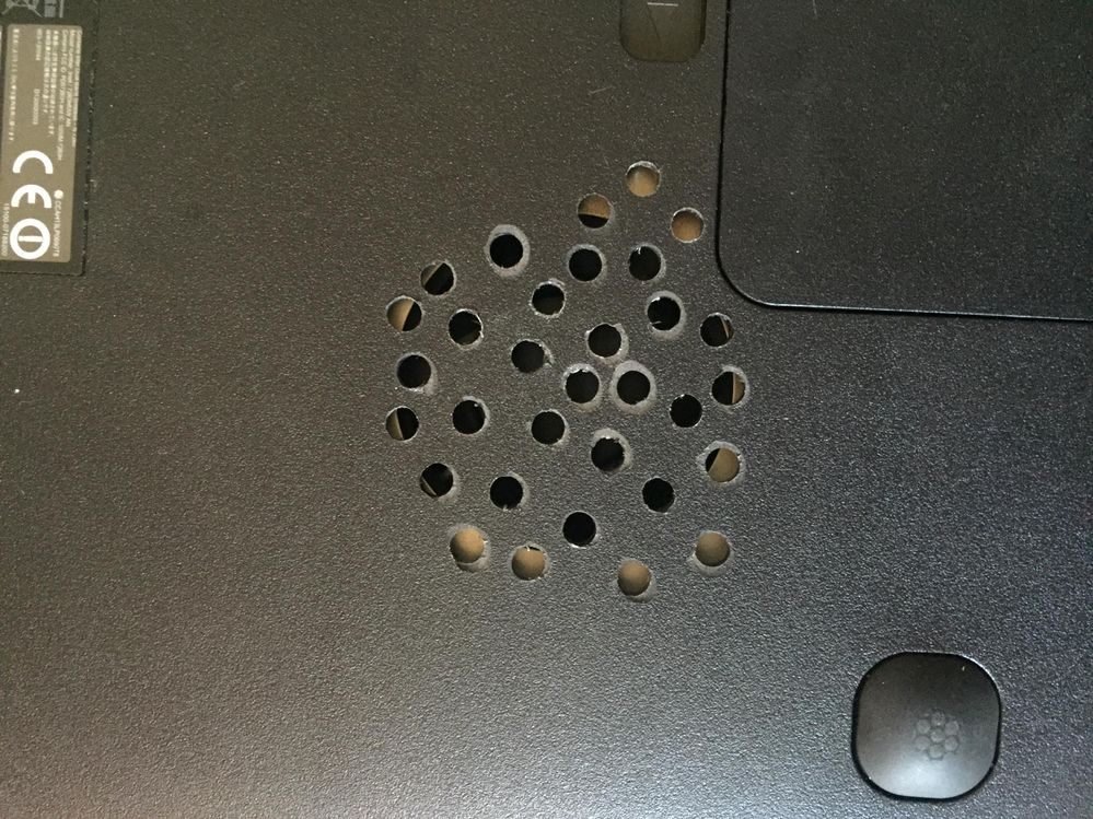

So, to cut the chase. I drilled about 15-20 4mm holes under the cooler(voiding my warranty which i will not need because the temps do not reach over 80 degrees celsius now) to actually help the vent get much needed air into it(also helped by a coolerpad which shaves of another 2 or 3 degrees).

Small update. I have replaced the mx4 with Coollaboratory Liquid Ultra. Temps have been consistent during the last month so i will report that this is a much a needed paste for laptops. As a side note i currently have ~23C in my room. Laptop sits in idle at 31-32C and fpu stress testing has reached a maximum of 72-73C with this paste after a month of heavy usage(12H+/day).
2nd and 3rd update: After 3 months of using the Liquid Ultra paste, the temps are the same in full/high load. Cooling pad maybe shaves off 1-2 C but not more, so it is kinda useless now(except i need it to hold my laptop higher).

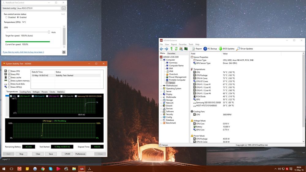

The better part is that i finally found a mesh to finish my cooling idea from an old coolerpad i had put somewhere. I have included a short fpu stress test. Temperature goes from 32 C idle to 60C > 65> 68 C and then slowly rises to 74 without cooling or 73 with external cooling.

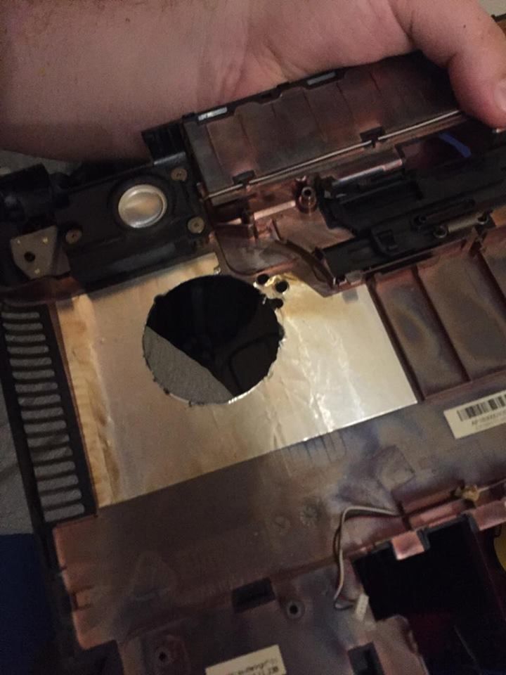

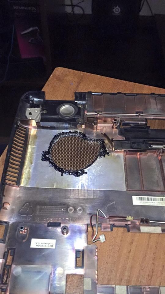

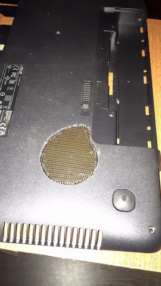

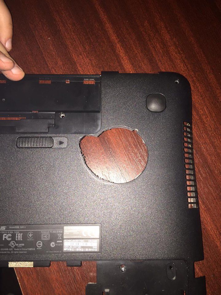

Pics are below, the shape is non-conformist because the initial holes were a tad larger and the corner of the battery did not let me drill a large round hole as i'd wished.

Did you happen to take any pics of the mod?
I'm gathering you didn't take apart the notebook (from what I read) to clean up possible plastic shaving bits getting inside from drilling those holes? Then it's probable that it also means you haven't done a repaste either? It's a pretty big difference in temperature with just an intake mod alone, isn't it? Even on a single fan cooling design.

Hey, thanks for kudos ! I did take the laptop apart, repasted and drilled the holes from the inside out on the back cover cleaning whatever leftovers i had from drilling. It doesn't look pro like your mod which is awesome btw, and i had a thought about the large hole + metal mesh but couldn't find the mesh anywhere in the city so i resumed atm to just drill the holes.
LE: i will probably do the copper modding later as atm i have no idea how to this. and the reason for voiding the warranty is that i do not care that much for it after some time a product runs without flaws. In my pc gaming cases days i had an antec 900 drilled cut and wrecked by factory standards including elastic cords to hold hdd's and an old mixer handle on the top side to put my headset in.

This is how and where it is and i do have to underline that it is far from being a pro mod, mostly because some materials i don't seem to find around here. i opted for the holes to go a bit out of the cooler's diameter because i have noticed that the cooler seems to draw more air from it's exterior circle rather than interior. Also the airflow drawn from here is a lot bigger than that from the keyboard since the cooler draws air from both sides.
I will probably go for some pentagon shape to keep an aggresive design. But this is personal preference for when i add a metallic mesh and decide to actually cut the portion of plastic.

It looks good and although I'd have aligned each hole with equal spacing apart from the next, does not mean, it invalidates all the work you've done to get to that point! I believe in function over form anyway and if you can balance both that's even better but it's not a requirement! After all, this was your goal and after reading the successful results, that you've achieved it. This goes a long way when undertaking future mods, believe me!
It's through this kind of self-teaching are you able to gain enough confidence in yourself to keep improving upon it with each new experience.
Thanks for sharing the picture! I look forward to viewing more of your mods in the future!
