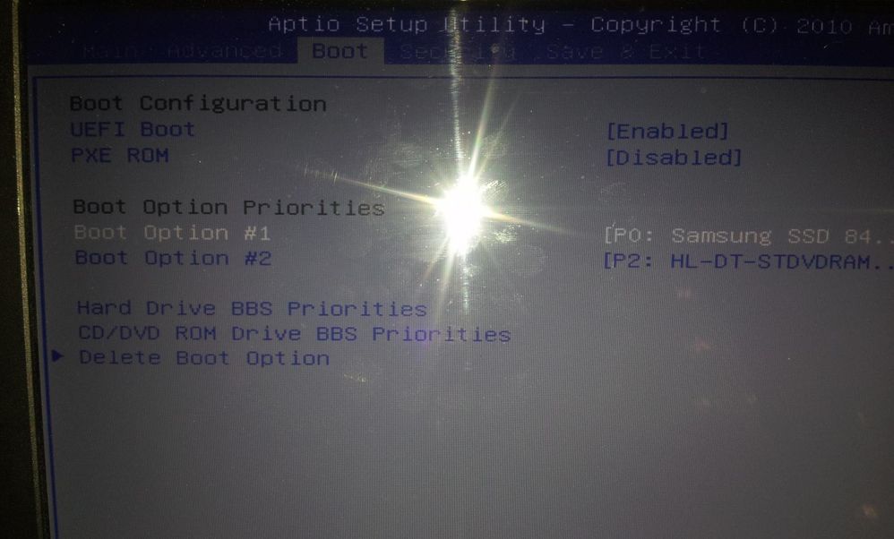

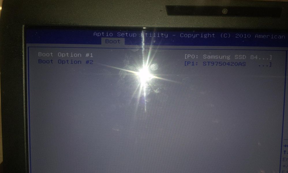

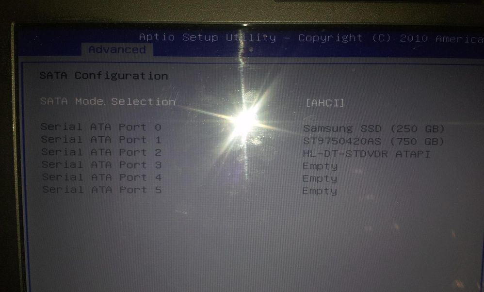

To my suprise, it seems that when the SSD is attached to the Port 0 1st port (as seen in BIOS) it will work (be detected always).
See attached pictures from BIOS screen shots.366593666036661
At first, i simply attached the SSD to the other Port and left the extra drive bay empty.
Did a Win 7 installation, and it seemed to have completed successfully without any issues
(after a few reboots i was at the logon screen).
Then, just to make sure, I shut down the laptop, re-installed the SATA disk to the remaining Port (Port 1 as seen in BIOS) and tried
to re-run a Win 7 clean installation on the SSD. Again, it worked just fine, and then again after some reboots i was at the logon screen.
Now, i have been restarting, powering off and on the laptop for some time now (approx. 30 minutes) and i haven't got not even once
the 'not detected' issue as before. It could of course be just a matter of luck, or just happens to work now.
I will continue to test and confirm back in 1-2 days if all is good.
But it seems as though, the G53SW-A1 (exact model i own), will always try to boot the 1st SATA port. (Port 0 in BIOS).
Also, if you have 2 drives like myself, 1 SSD and 1 SATA, you will also need to go to the Boot Order Section in BIOS (see additional pics)
and set your SSD as 1st Boot Option, then the 2nd Boot option will auto-set to the internal DVD drive.
Finally, you should go to the 'Hard Drive BBS Properties" on the same page were you set the SSD as 1st, and Set as well the
Boot Option #1 to the SSD (will be seen as P0: Samsung SSD etc or your own SSD), and then set Boot Option #2 to your other SATA
drive, seen as P1: STXXXXXXXX (in my case). Obviously, the P0 and P1 stands for PORT 0 and PORT 1, where the laptop always tried to boot from the P0 drive.
