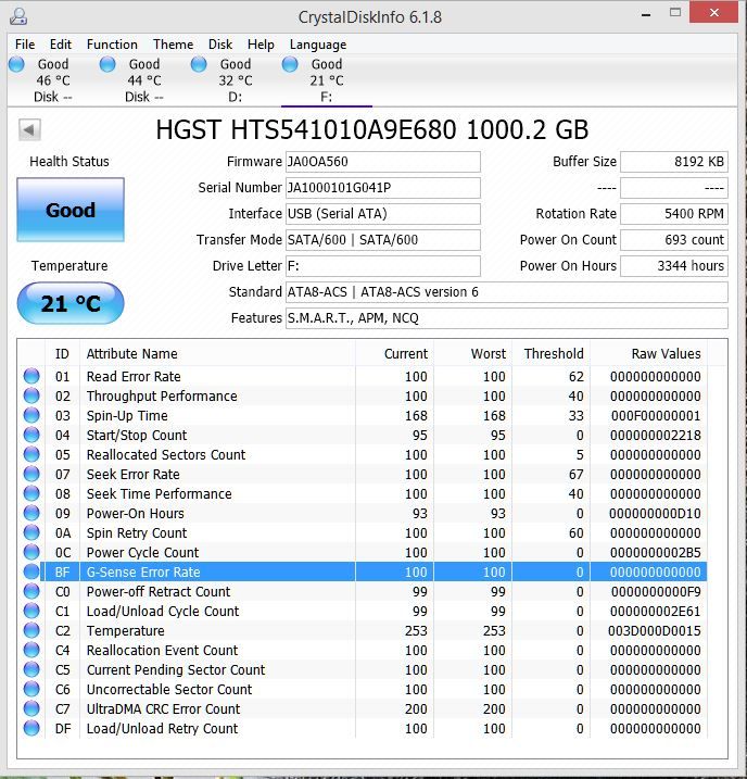

Here is the G-Sense/SMART info for my 1TB drive. My count is at 100, and if you look at the comparative data the ratio of power on hours vs G-sense count your numbers don't look out of place.
41129

You are looking at the current values, not the raw values. A higher current value is good. A higher raw value is bad. My current value is at 22, while my raw value is at 78. Your current value is at 100 while your raw value is at 0.
It really means that your G-sense error rate is perfect.

signofzeta, got it.
Normalized 100 or 200 value Current / Worst is equal, with 0 RAW means no/0 count - idk if that is perfect or not used.
