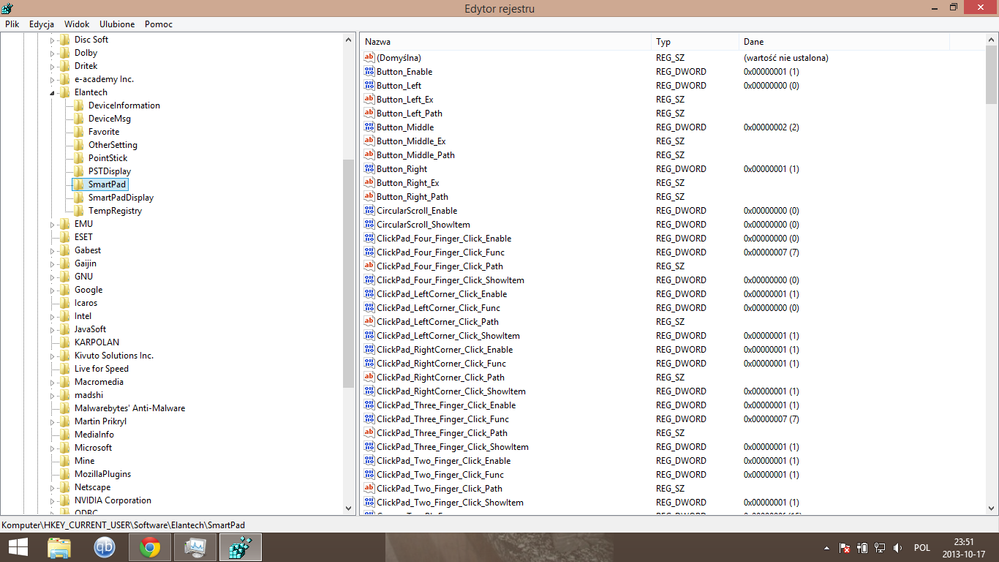

This is very common problem and till yet unresolved. The Elantech driver disables right button + left button touchpad click. In the result you cannot aim and shoot in games also you cannot code that kind of interaction in your applications.
Driver detects LMB+RMB click but it somehow filters it so there is no effect -> it is disabled.
I could not find correct entry in the registry to disable that obviously horrible setting.
