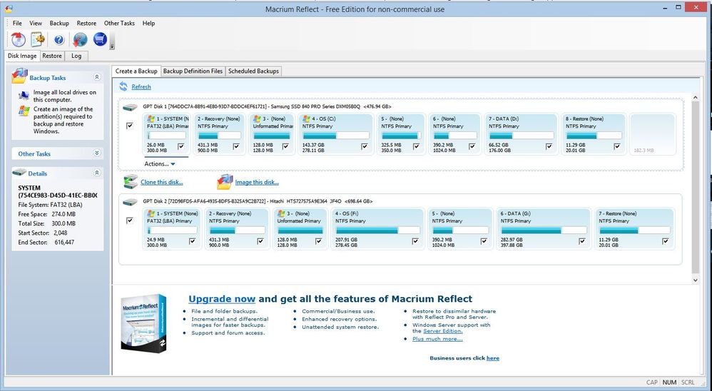

Here is what it looks like, cloning from 1TB HDD to 256GB SSD, and resizing the destinations:
47063
- advanced use - clone the first 4 partitions and skip cloning last 3 partitions - you only need the OS partitions and the C partition. Mega advanced, skip the leading ~1GB partition (#2) in front of the C partition - it's used for Recovery support. So only clone partitions #1, #3, #4 - unless you want to preserve the recovery partition and support on the boot drive 🙂
Have fun 🙂
