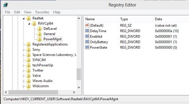

Here are the registry settings to turn off the power saving mode while plugged in
27122
Details for audio driver and registry locations in post #13
http://rog.asus.com/forum/showthread.php?37273-ASUS-G750JX-headphone-sound-problem./page2
