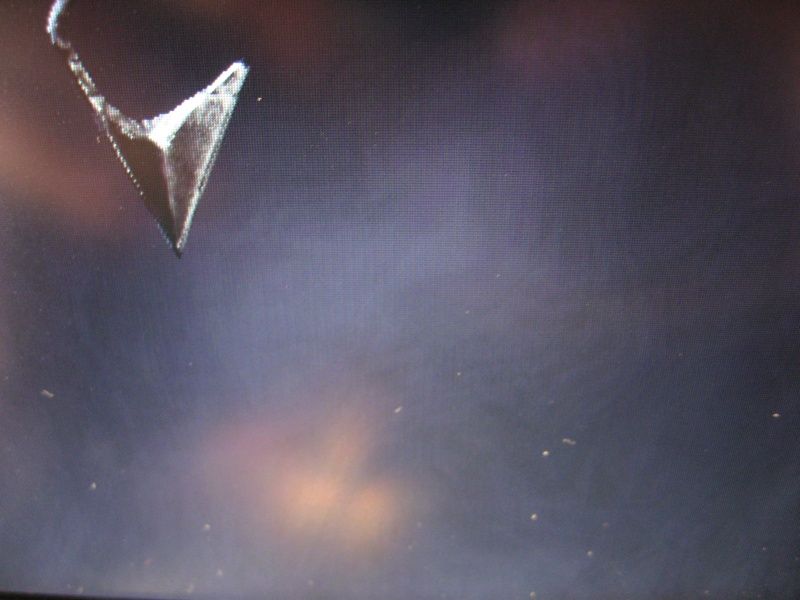

The picture Pierre990429 posted shows it quite well:

Pierre990429 has replaced his screen 2-3x, and is back to the AUO, which I guess is least objectionable to him.
