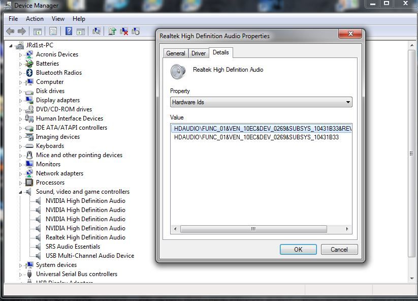

When I just looked at the downloads page for G73JH, Realtek SRS drivers were listed, not Realtek HD. If you installed the wrong driver uninstall that one and ......
If you aren't sure which to use, go into device manager and find your sound device and look under details for the device id. Get back to us with that.
Read the User's Manual for more info. 😄

I have the SRS drivers installed right now. As for the device ID, im not sure how to get that. There are a lot of details about it, but youll have to name me the specific one, since there is none called Device ID.

I'm sorry, it's Hardware ID
3914
You see the 0269? That means it's the Realtek ALC 269 sound device

Ok i checked. the ID is correct, exactly like your screenshot. Everything seems fine in the Device Manager. One thing that happened was that after i uninstalled my Realtek drivers the first time, i didnt restart before installing my Realtek again., wich makes me think there is some kind of registry screw up in Windows, and its glitched because of that, no matter how many times i uninstall restart and install.
