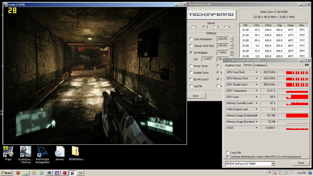

Problem is when running Prime95 the CPU stays turbo boosted at 2.3 to 2.6ghz. However, once Furmark is started at the same time, the CPU drops instantly to 798mhz. This now also can be noticed in GTA4,SC2,L4D2,WoW and anything that will put high loads on CPU + GPU at the same time. It does NOT just happen during synthetic test.
The FIX
So how to fix it? Well so far it seems running ThrottleStop in monitor only mode stops any, and all throttling. You do not have to mess with any settings, simply extract and run the exe for it to work. If you would like to have it run on bootup, simply create a shortcut, and drop it into your start-up folder. To have it auto-close, go into the ThrottleStop.ini and change "DCExitTime=0" to any number you like(basically just means number of seconds before it closes, I have mine set to 5.)

There is no known downsides to using throttlestop, your CPU will still down-clock properly when not in use, and it does not run hotter, nor have I found any conflicts with battery draining faster.
Also, you do NOT have to worry about any overheating, even with throttling disabled I see no higher than a peak 81c on my CPU/GPU in a ambient room temp of 84-86f. So you really don't need to worry about that. However, the PSU does get hotter when throttling is disabled when there is significant load on CPU + GPU. So just watch for that, though it should be ok for the most part.

  • Using Throttlestop 3.00 stops the throttle, doesnt have to stay on, just be run once on boot.
  • HP released a BIOS update fixing the throttling problem for Envy 16 gen2 owners on May 29th, 2011.
  • Using realtemp 3.67 to log cpu during games has proven that throttling is happening outside of artificial test.
  • GTA4 is the most affected by throttling, frames are around 10-25, but instantly jump to 30+, once throttlestop is opened.
