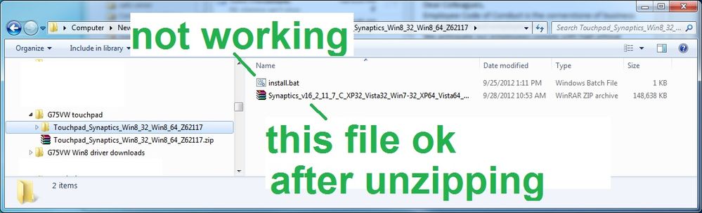

fyi. If anybody else is having trouble installing that G75VW Win8 touchpad driver version Version V16.2.11.7, it doesn't appear to be uploaded correctly.
After you unzip the download, there is a second zipped file that you need to unzip and run the install.bat.
There is also an install.bat file that appears the first time you unzip the download, but just ignore it.
