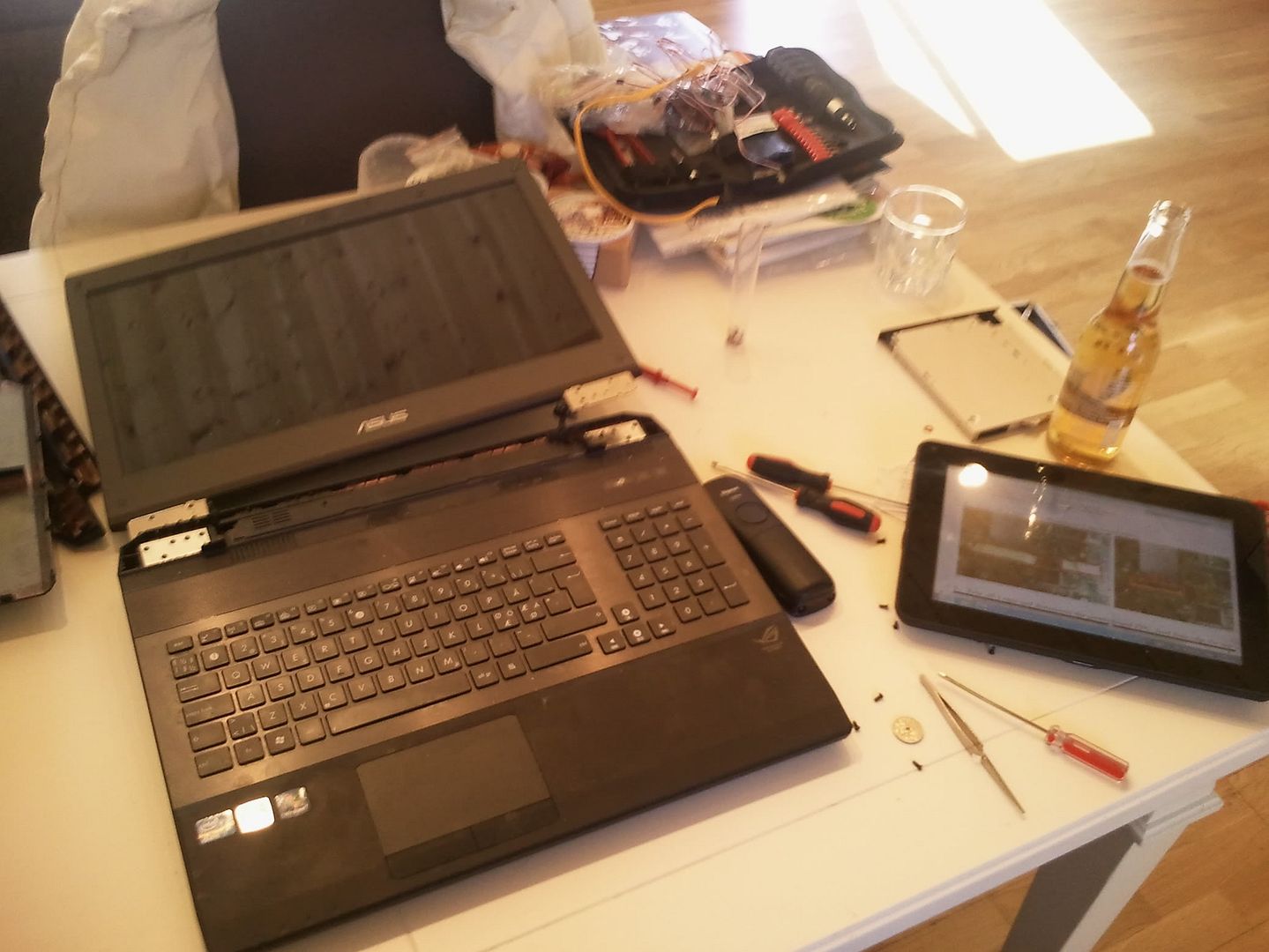

About to dissasemble my Asus g74sx. To remove dust from the fans, inside, and the cooling tract
http://i55.photobucket.com/albums/g157/utepils/Asus%20g74%20disasembly%20to%20remove%20dust/20120505...
Beer for motivation 😃

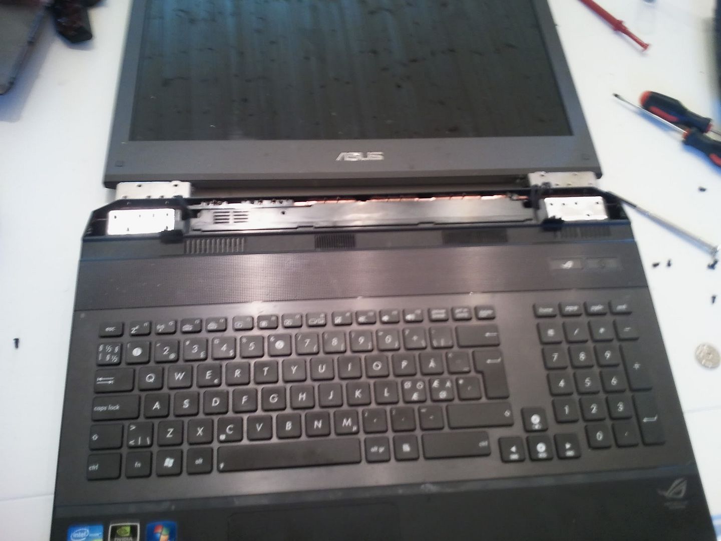

Removed the top lid. As you can see, after just 6 month, its gotten covered with dust. Inside computers, dust tends to get "greasy" and stick .

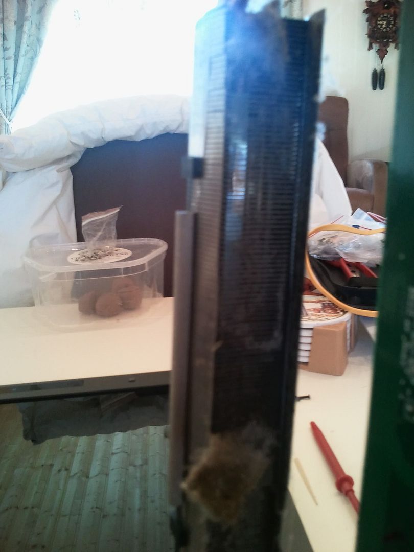

better pic of where the fans meet the heat sink. Ouf ... Took me a while to peel through it front to end, as its about 2cm "deep" And every reel was cleaned. Its now 100% blowthrough

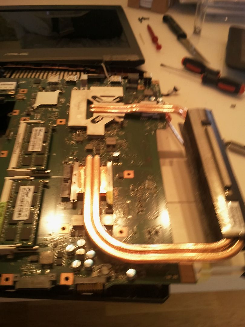

Clean 😃 You can also see where the heat sinks get theire heat. From the 560M 3gb GPU, and the i7 2630QM CPU.

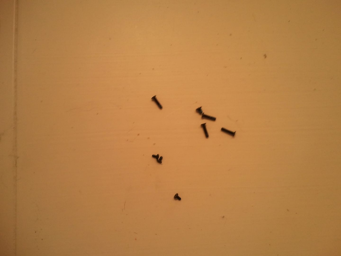

And as it should be .. Screw leftovers haha 😃 Quite alot aswell haha
