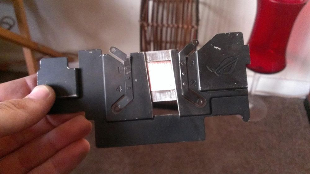

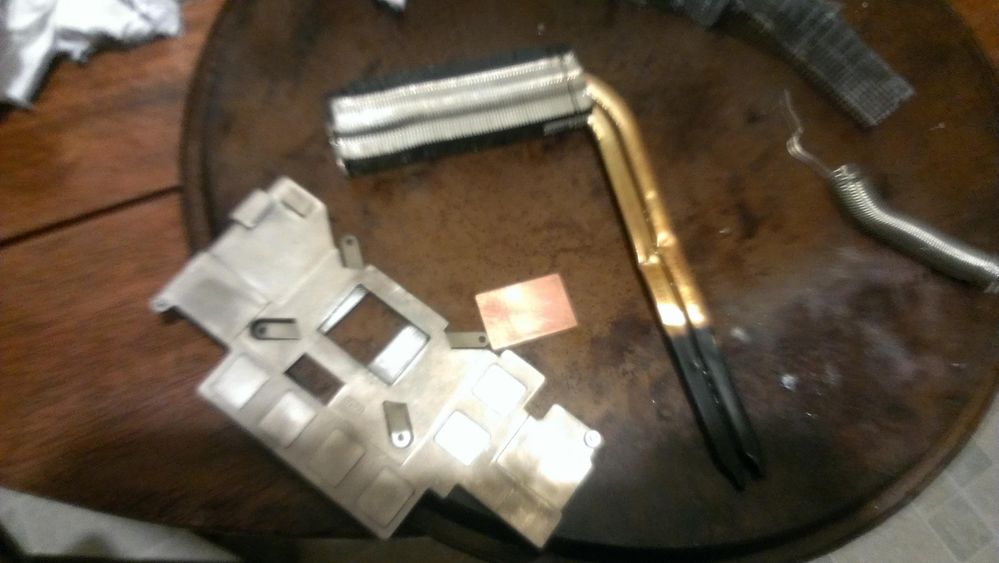

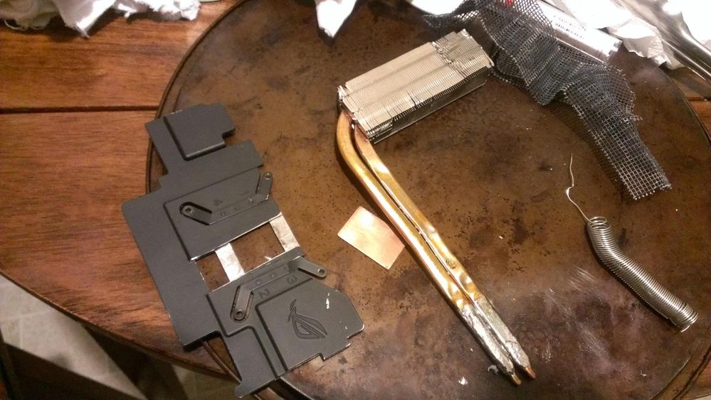

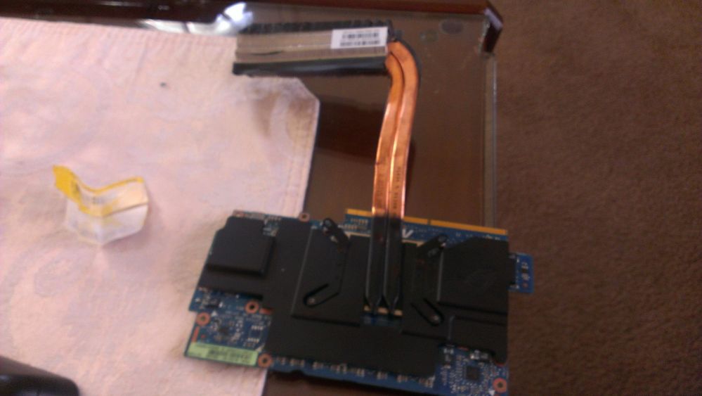

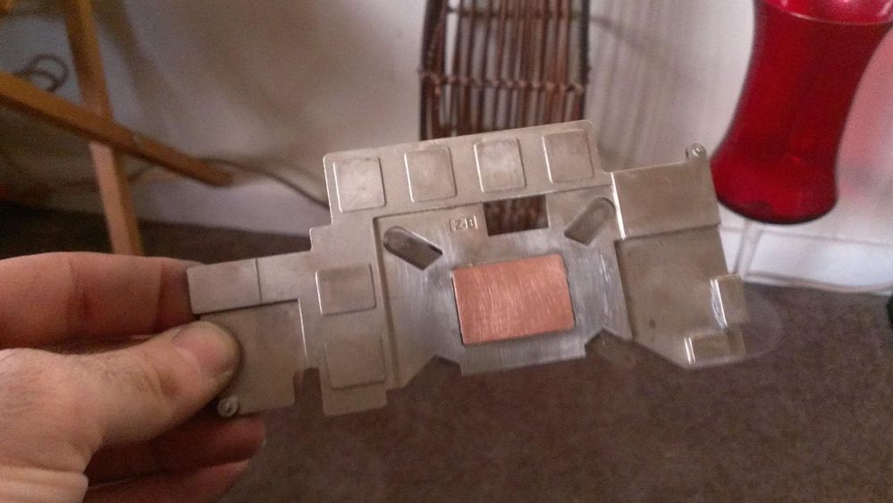

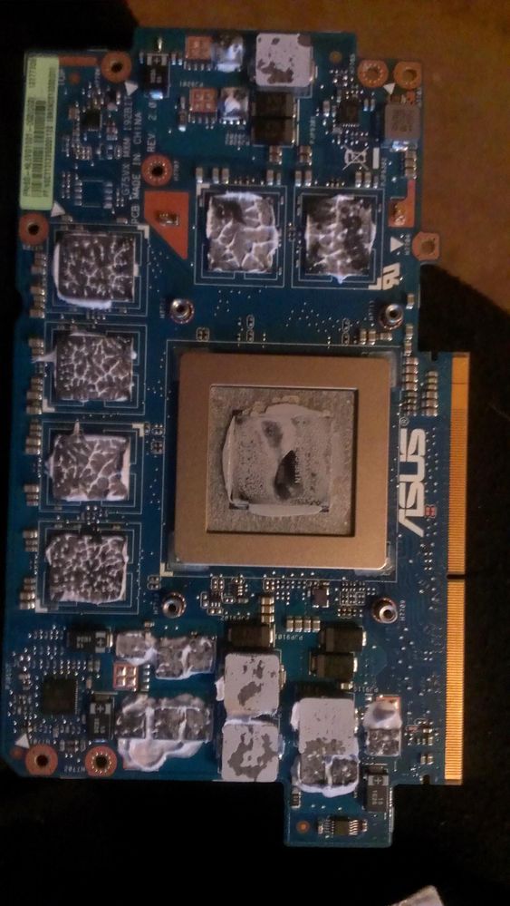

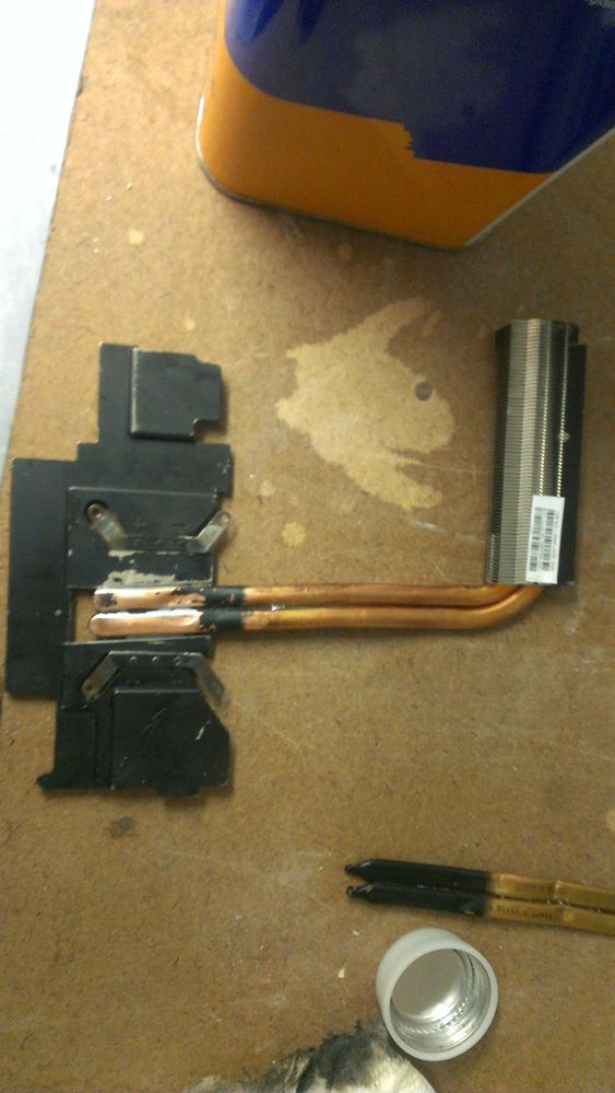

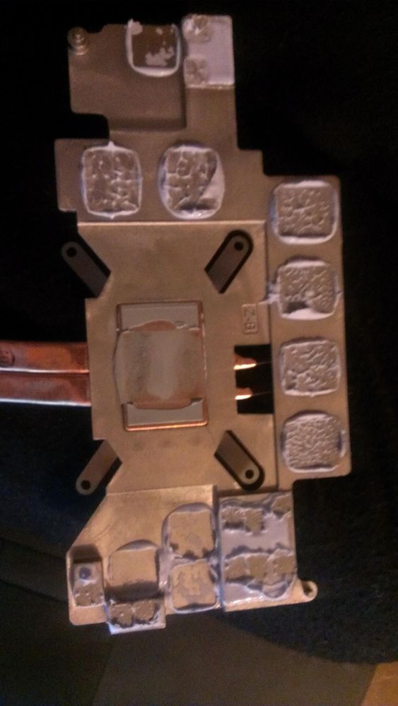

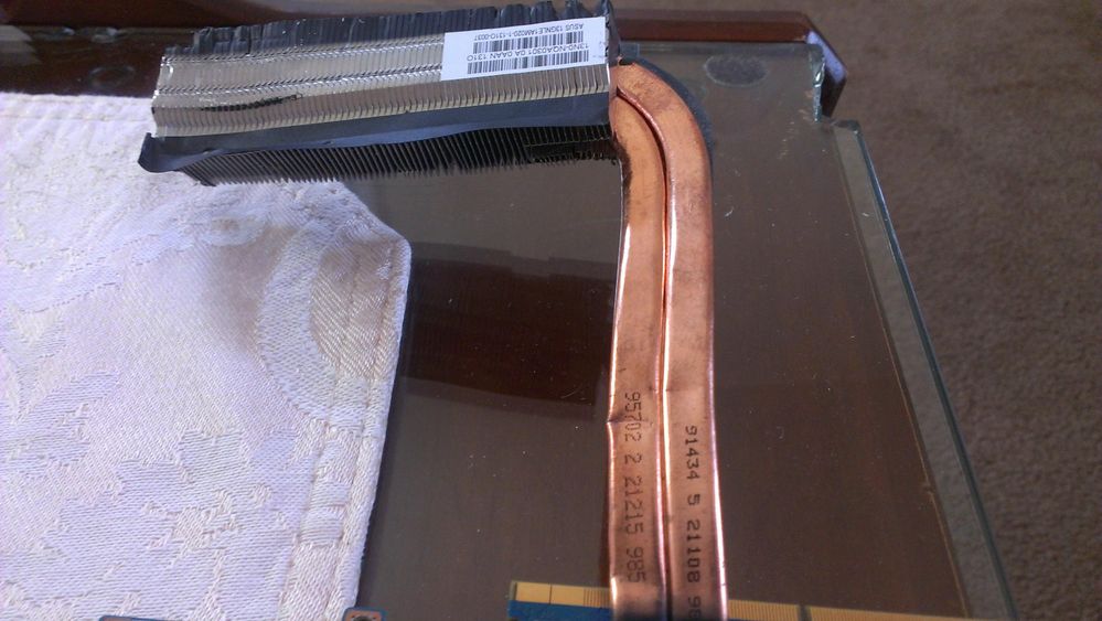

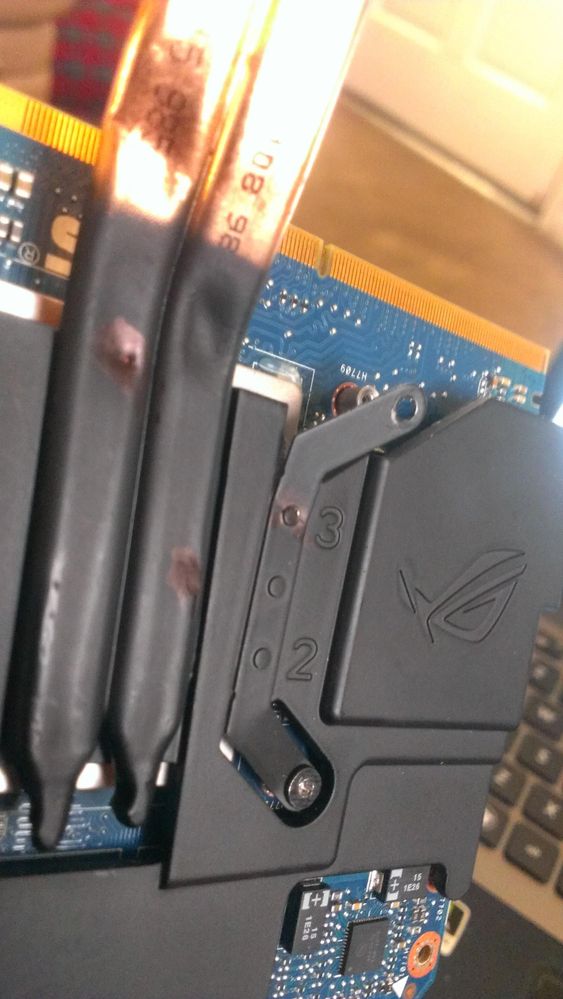

So Dreamonic has been telling me to share this with you guys for quite some time now, so, here it is. I swapped out the 660m in my g75vw with a 670mx I bought on ebay. Boy was that a process. The guy hid that the heatpipes were damaged in his ebay pictures. I had to take the pipes off my 660m heatsink and resolder them to the 670mx heatplate to create a new sink. The results? Apparently a card with a heatsink that cools a little better than the stock one :cool: Pictures below of the card before and after.Worth every second put in to make this mod happen. The card is now voltmodded @ 1.1mv running a stable clock of 1176 mhz core and 2302 mhz memory. The swap was fairly easy, and should anyone be considering doing the like at any point I would be more than happy to help.
