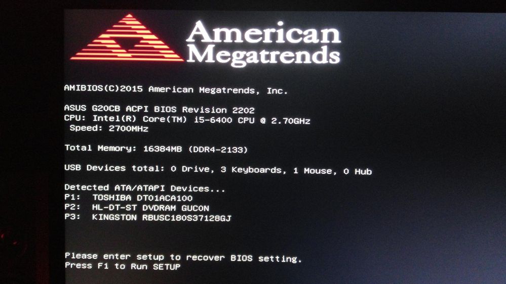

Yeah, I saw that post and I already did that, but thanks anyway. Also I was wrong, the BIOS screen reappeared today, here it is if you were wondering:
94901

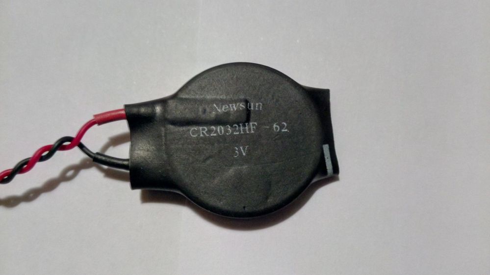

Turns out the CMOS battery was dead, which explains a lot of things and also means that the new ram wasn't the culprit. I will let you know the results after I change it. Can you suggest me a compatible replacement? Here is the original: 94974
Good news! I managed to fix the issues after changing the battery, but i'll explain the full story because more things happened in the process.
Finding a new battery was quite challenging since these wired models aren't easy to find, but i found one eventually. Then, i plugged it in the motherboard and when i turned on the system, even the onboard HDMI gave me no signal, meaning that i couldn't see anything! At this point i was quite desperate and since i had nothing more to lose, i attempted doing another CMOS reset on my own. This morning I opened it up and i swapped the CLRTC pins for 10 seconds, while leaving both the battery and the GPU cable plugged in. Thank God it worked! The Nvidia GPU was finally back! As soon as i booted into Windows, i reinstalled the nvidia drivers, and everything was back to normal, almost. The integrated GPU was still missing for some reason, so i went into the bios once again, on the system agent configuration, on graphic settings, and i set the iGPU multi monitor option to enabled. And it worked! now both iGPU and dGPU are detected by the system and the startup issues have ceased completely, meaning that the new battery works perfectly. I hope this thread will be helpful for other people in the future, and thank you everyone for your support! Back in business i guess.
