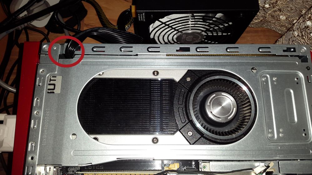

-How to pass the PCI-E power cord from the G20 case so that Graphics Card Bracket sits properly on its place?
I first started by ordering a Green 600A HP Internal PSU which has by standard 600W power and 45 Ampers. One of the best things about this product was that the wires were so soft and could be bent easily without being damaged. So I simply plugged the 6+8 pins sockets and placed the out going power cord at the edge of the case which has a small hole.
54541
As you can see it really nicely fits there. So now only remained one more thing which was making the PSU work Direct.

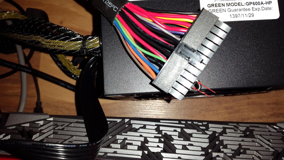

On that 20/24 pin socket there are 2 holes which behind one of them is a Green wire and the neighboring hole has a black wire. You need to use a U-bent Insulated small wire connecting these two so that you PSU work as soon as you press the power button behind it.
54543
So doing that, you are set to go.
