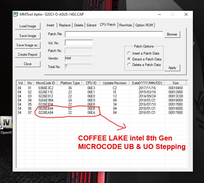

This started months ago when I opened ver.1402 G20ci Bios with MMtools. I found out that this latest G20ci bios have coffelake intel 8th gen microcode inside. Asus must be prepared for coffe lake processors with G20 intel 200 chipset, but intel didnt allow it.
80265

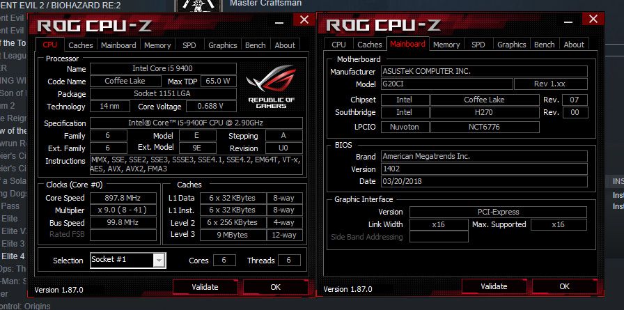

This made me curious to try the coffelake processors with my G20ci. so I tried i5 8400 on it, but it didn`t work.
With some research finnaly i found that intel not allow intel 200 chipset board to recognize coffe lake processor if the board using intel ME 11.8.x.xxxx firmware, so i downgrade the firmware to 11.7.0.1229 with flash programmer.
And voila, i5 8400 was detected, and runs well. Then i tried i7 8700, it didnt work, but after learning from here: https://www.win-raid.com/t3413f16-GUIDE-Coffee-Lake-CPUs-on-Skylake-and-Kaby-Lake-motherboards.html finally i am able to make it works.
Not stopping there, i am also tried 9th gen CPUs by adding another microcode, tried i5 9400f and i7 9700k, both works well.

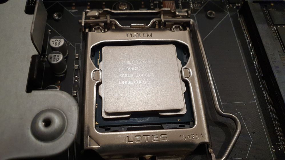

Now I am using Intel Core i9 9900k on my G20ci.

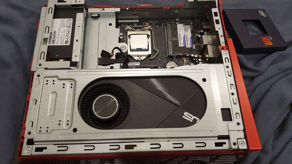

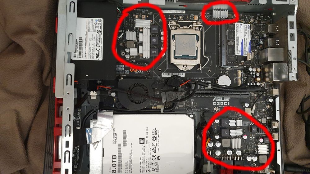

The main problem is the Board`s VRM get very hot when running 6 core processor and above. So I put extra heatsinks on the vrms chip.
80271
80268
i9 9900k with 16 thread wont run stable, VRM gets too hot easily and pc will shut off automatically when running apps. Then I disabled the Hyper threading and runs with all 8 core without HT, it works well.
80265

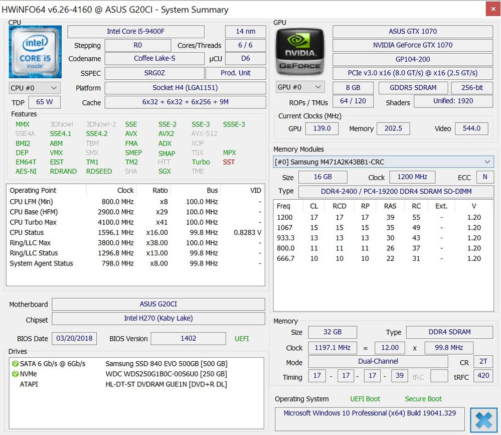

hi togheter,
last week i went trough the journey of upgrading the CPU to the 9400f form 7700.
it was a long way to a successful running and finaly stable system again.

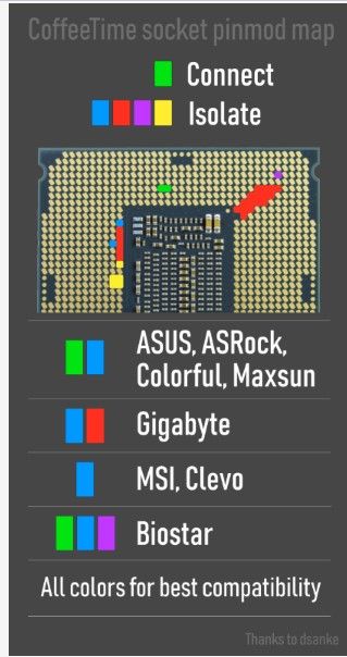

very important, you must cover the ASUS pins (BLUE) according to this image:

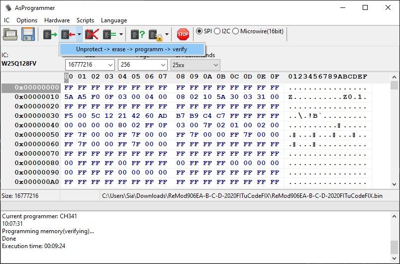

for programming the BIOS you need to take the chip out and flash it with for instance a CH341a Flash Programmer
as software you use the AsProgrammer_1.4.1 and then you flash with overwriting the flashprotection!

UPDATE 2 it works now! Lost_N_BIOS made a new bios that unlocked hidden menues form BIOS:
[ASUS] High voltage VCore (up to 1.5V) in the “Auto” mode is a proprietary bug of ASUS motherboards. The problem is solved by setting the value “0.01” for the parameters “IA AC Load Line” and “IA DC Load Line”.
[ASUS] The “2.1” value for the “IA AC Load Line” and “IA DC Load Line” settings will help to remove throttling on 2xxx bios
after setting the “IA AC Load Line” and “IA DC Load Line”, i could boot windows and run everything like normal.
i have stresstested the System with Prime95 and several Benchmark Utilitys. so this is a final win!

the pin connecting is not needed but the isolating is a must otherwise you'll ruin your mainboard.

First of all thanks for your reply, time and insight on the matter. I will take your advice. I will upadte my current system the latest bios ME version and windows intel ME version then head over to (https://www.win-raid.com/t3987f16-TO...html#msg114175) and ask for Lost_N_BIOS's assistance. Hopefully all goes well. However before I do I am asking for clarity on two things;
1. On the Asus g20ci driver site (https://www.asus.com/us/Tower-PCs/ROG-G20CI/HelpDesk_Download) the latest stock bios 1402 includes a non-oculus version and oculus verison. Is it a must I use the oculus verison for the modded bios? Or can I use the non-oculus one? Reason why I ask is because when I first got my computer I had tried to upgrade to the stock oculus bios version and got a boot loop after posting so I switched back to the non-oculus one without issue.
2. Please note: The cpu I want to upgrade to is intel 8th gen i7-8700 SR3QS which has apparently cpu stepping according to https://www.win-raid.com/t3987f16-TOOL-Easy-automated-Mod-tool-for-Coffee-Lake-bios.html. You said that I would not need to connect any of the cpu pins. Good. However my question is what is the best substance recommended I should use to isolate the required pins in order for this modd to be sucessful?
