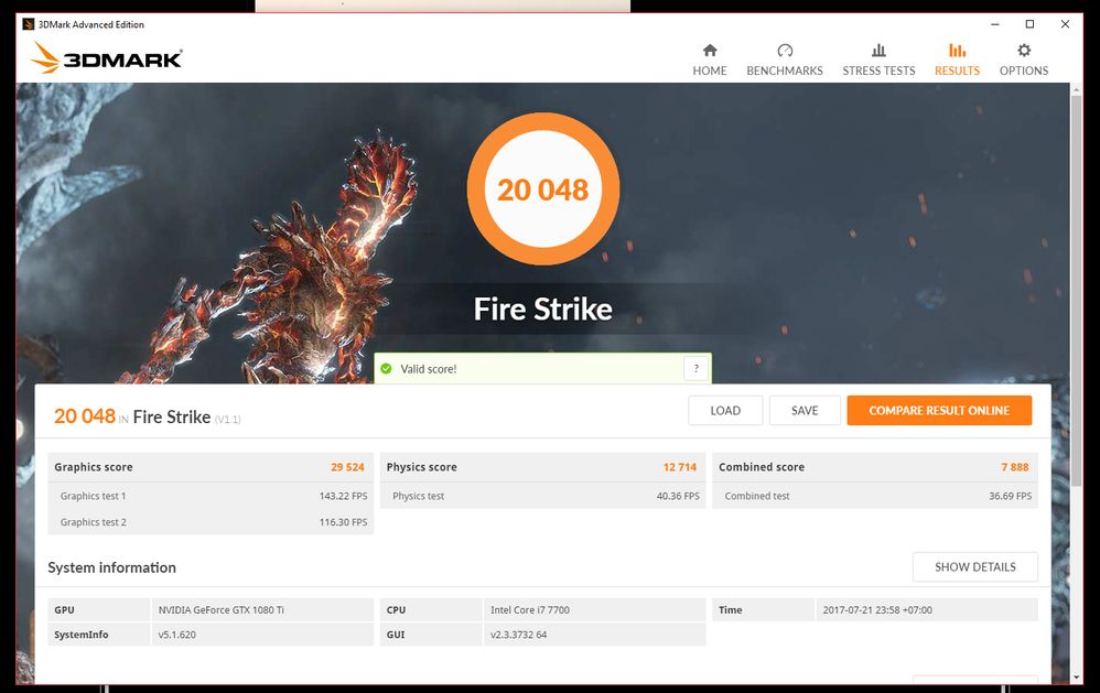

I just replaced the gtx 1080 in my G20ci with gtx 1080ti, it was unofficially supported but my curiousity really want to give it a try, and above my expectation, it works perfectly.
Tried many games and benchmark it was very stable. I even tried firestrike 3dmark loop for 6 hour with mild overclocking, +120mhz for the core and extra 500mhz for the mem and it works nicely with max temp 88 C degree.
Unlike my G20ci, putting gtx1080ti in G20Aj will only works nicely if I lower down the power target to 90%(with msi afterburner), and can`t overclock the GPU at all or else it will crash. G20AJ and G20ci have the same power brick 1x180w+1x230w, but somehow this 250w tdp gtx1080ti can works perfectly on G20ci but not in G20Aj, my guess that might be the G20ci board(H270) PCI-e 16x port that can deliver extra watt for the gpu.
Here is my firestrike 3dmark score link: http://www.3dmark.com/3dm/21152748
