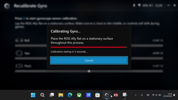

Calibration: Start by ensuring the gyro is properly calibrated using the Armoury Crate settings. Navigate to the Calibration section under Settings, place the Ally on a flat surface, and complete the calibration process. This helps eliminate any potential "ghost" movements that could interfere with precision.​
Read the How to Guide here if unsure on how to calibrate the Gyro.
