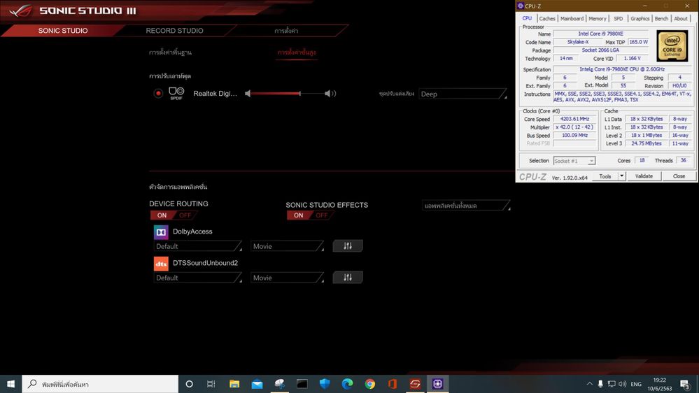

85242
Thank you @MokiChu your info and new driver working very well. 😮
Microsoft Windows 11 Insider Preview Build 25375.1ZN Intel Core i9 7980XE 2.6 GHz 020006F05 Microcode ASUS RAMPAGE VI EXTREME MODDED BIOS 3701 SAMSUNG ODESSEY G9 FIRMWARE 1017.0 NVIDIA RTX 4090 24GB GDDR6X 256GB GSKILL DDR4 16-18-18-36 3200MHz SAMSUNG EVO 970 PLUS 1 TB x 3 HARMAN JBL 9.1 Sound Bar DOLBY ATMOS 9.1 :cool::cool::cool:
