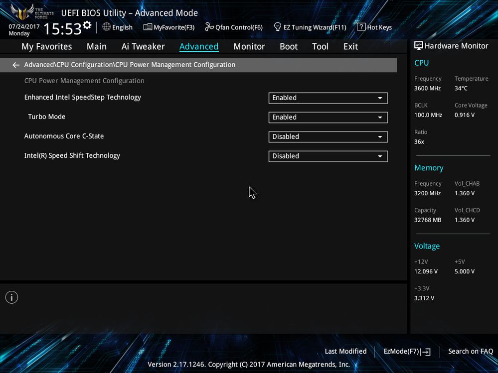

Anyone know what this new setting is?
0402
66363
0503
66364
