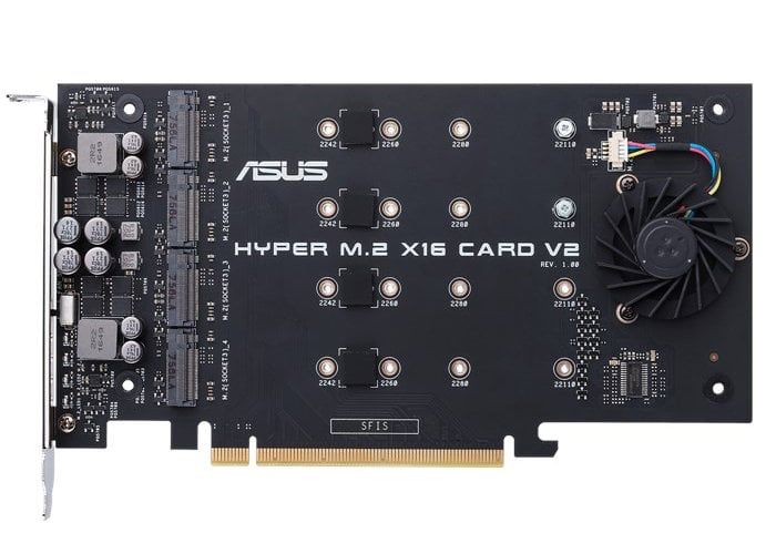

์No mate , Due it was different controller , DIMM.2 were use CPU and PCH lane PCIe 3.0.
85845
To setting up RAID-0 you must use ASUS NVME RAID card instead of DIMM.2.
Windows 11 Canary Build 25951.1000 Core i9 7980XE 02007006 MCE ME 11.12.94.2479 RAMPAGE VI EXTREME OFFICIAL BIOS 3801 SAMSUNG OG9 FW 1019.0 NVIDIA RTX 4090 GAME READY 550.09 64GB GSKILL DDR4 16-18-18-36 3200MHz 970 EVO PLUS 1 TB x 3 HARMAN JBL 9.1 Sound Bar DOLBY ATMOS 9.1
85845
Dear restsugavan,
I have sent you a PM.
It looks like a neat device however I am not sure if the encore board allow to have PCIe bifurcation.
Thanks fro your help.
