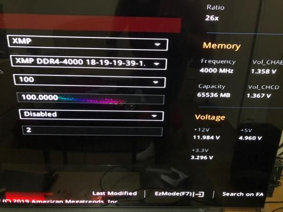

i'M having issues with my memory kits.
when I use the XMP 4000, many times the system does not boot and I see "code 80 system cannot detect memory" on the status screen.
Memory is on the qualified vendor list: G.SKILL TRIDENT Z, DDR4, F4-4000C18Q2-64GTZR PC4-3200 CL 18-19-19-39
Another annoying thing is that If I shut the PSU off, when I turn on the PC again, it shuts off for a second then turns on again.
I'm NOT overclocking, as the memory capacity is 4000hz by default.
can I get some help to stop this from happening, please?
Thanks in advance.

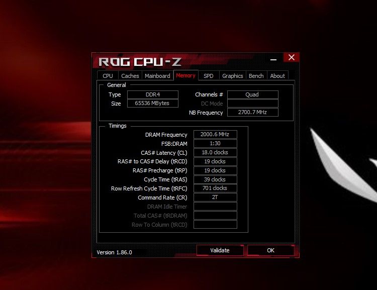

my actual config is this:
Intel core i9 7980xe cpu
64GB ram G.skill 18-19-19-39
Asus Rog Rampage Extreme Om ega
1TB WD Black SSD nvme
2x Nvidia RTX 2080TI
